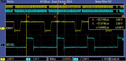

We have the PCI1520 programmed to the fastest IO speeds we can find. An Oscilloscope shows IORDY going low for about 220us and then remaining high for 800us. That proves the CF card isn't slowing things down by inserting any wait states. I would have expected that the IO cycles should be able to be closer together than this.
Meanwhile, on the PCI side of the bus, the PCI1520 is obeying the rules and "giving up" after 16 PCI bus cycles, forcing the PCI master to retry. This is called a "Delayed Transaction". The following trace shows the CF/PCMCIA "IORDY" in Yellow and the PCI "DEVSEL" signal in Blue. At the top of the picture can be seen the 256-word bursts as the CD disk sectors are being read, and the gaps between them.
It looks like the state machine in the PCI1520 is taking a while to start the PIO cycle, and can't get the data read in less than the 16 clocks (500us) at which point it is required to force a "Delayed Transaction". This then wastes another 200-400us or so while the PCI bus retries and then runs the next cycle.

    I'm now writing to the Diagnostic Register and it does prevent the "Delayed Transaction". It hasn't changed the resulting timing at all though. Each cycle ends at pretty much the exact same point that it does with the retry in the middle, and it doesn't then start any earlier. Each transaction is taking about a microsecond as shown in this trace:
    It is taking about 400us from DEVSEL (which indicates the start of a PCI cycle) to IORDY, which takes another 200us. Then there's another 200us before the PCI cycle is completed, even though the data is available at the end of the IORDY. Our PCI master is then taking another 200us before staring the next cycle. All up about 1000us per transaction.

  • Hello Tom,
    Unfortunately, the PCMCIA cores present in all TI CardBus controllers were designed for compatibility with the broadest possible range of devices rather than performance. There is no functionality present that would allow for improved performance.
    Regards.
