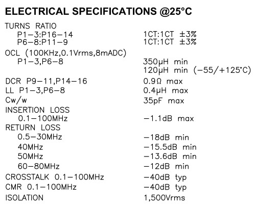

In the datasheet there are listet some recommended transformers. In case of space we considered to evaluate the TG110-EX50J2LF.
The values diver from the Table 137.
How do they infuence e.g. the Ethernet-compliance-test or can it managed via the external components?
