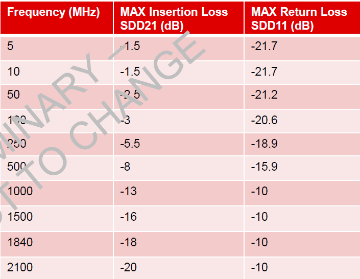

    One more question,  Is it possible to use FPCB(flexible PCB) for connection between 953 and 954 instead of coax, STP/STQ ?
    JH..

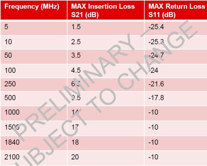

  • Hi Hamzeh,
    One more question from customer.
    In case of coax, Is there limitation of cable diameter ?
    They have 0.64~0.8pi of coax. Is this okay to be used ?
    What is feasible max length of coax cable ?
    JH.

    They can use FPCB instead of Coax or STP. But they have to make sure that they do not have EMC/EMI issues. You know the cable has always shielding but the FPCB not! Also the traces on the FPCB should be 50 ohm for Single ended and 100 ohm for differential pairs.
    There is no limitation for cable diameter for FPD-Link itself, but this may affect the max. PoC and increase the cable loss.
    We do not specify max. length of a cable since there are different manufacturers and cable types. What we specify is the maximum allowed insertion loss and return loss on the link.
    Coax Channel requirements
    Differential Channel requirements
