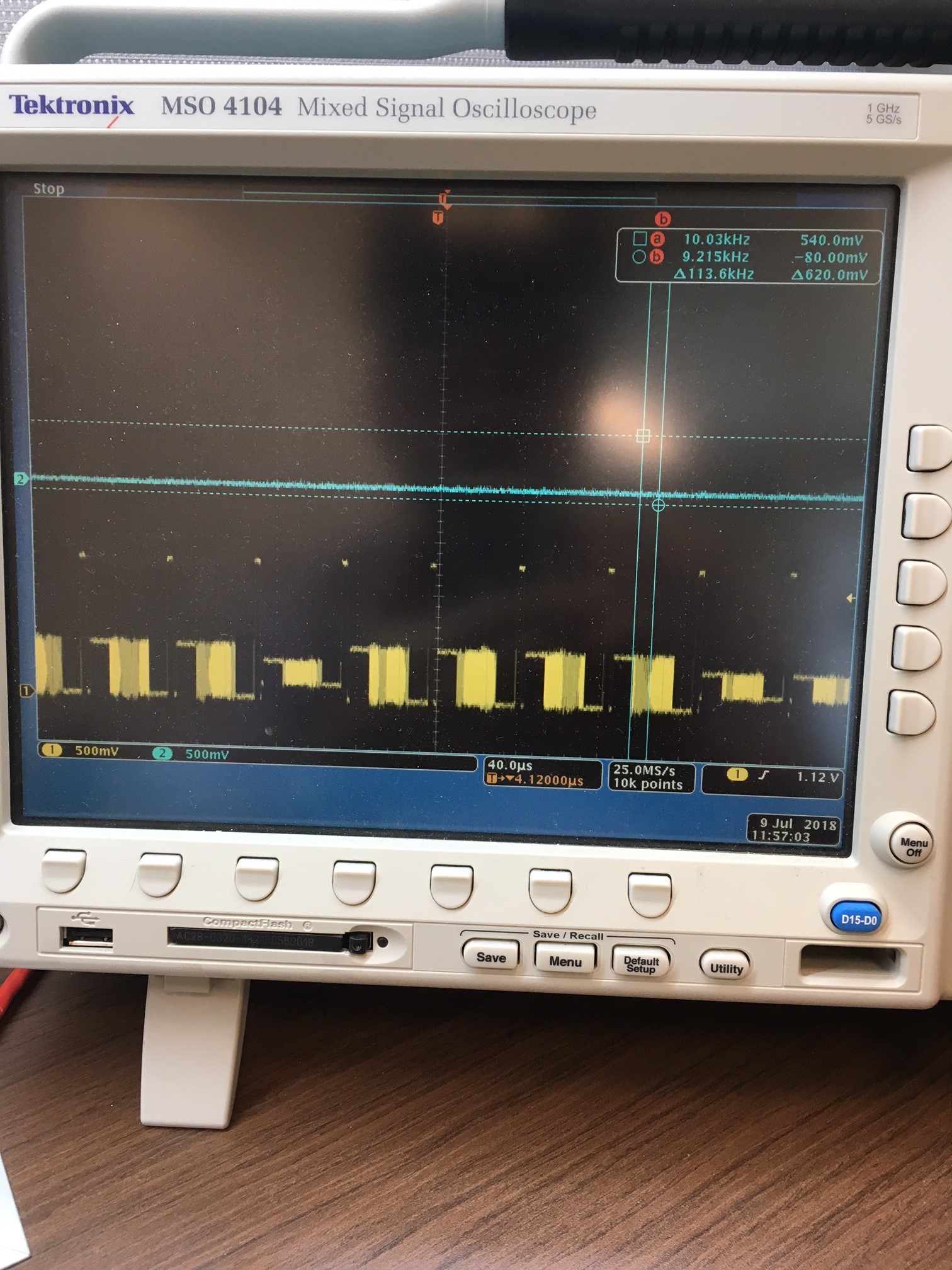

My customer is having issues communicating between the '943 serializer and '954 deserializer. When they monitor the the CSI-2 data coming into the '953 with a scope, the high speed section of the data alternates between roughly 500mV and 210mV pk-pk (see below image). When they hold the PDB input of the chip to ground the issue does not happen, high speed data is consistently just below 500mv pk-pk. They suspect that the terminations to the DPHY in the part are somehow changing. Any ideas what could be causing this?

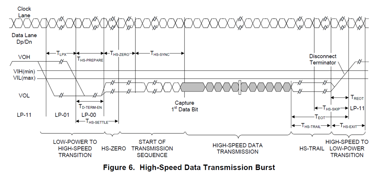

    It is likely that you don't have proper termination. Could you check other CSI-2 lanes to see if they are also having the same issue?
    In High-Speed mode, you should be seeing ~200mV swing. Could you check your protocol to make sure that the sequence to enter HS mode is the following: LP-11, LP-01, LP-00 with correct timing (shown below)?
    As a debug step, you could force termination on the 953 by changing the values on register 0x24.
