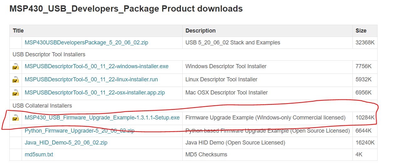

    a) Go to link below
    www.ti.com/.../MSP430USBDEVPACK
    b) Click on the "Get Software" link and download the highlighted file below
    c) Install MSP430_USB_Firmware_Upgrade_Example-1.3.1.1 Software (just application only, no source)

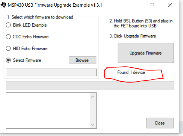

    d) After install run MSP430 USB Firmware Upgrade Software. Follow steps on the opening screen
    e) For your board BSL button S3 is switch S1. You have to hold S1 down and connect USB to the board for MSP430 to enter into BSL mode and recognized by this tool as shown below
    f) Save and select the firmware hex file (enclosed below)  and press upgrade
