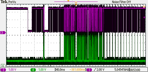

  • Hope this will be sufficient, I have a scope with only 200MHz bandwidth.
    On attached images is the enumeration of USB keyboard HP KU-1156. The keyboard works, the USB flash drive does not...

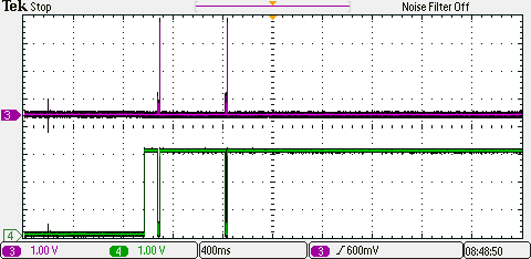

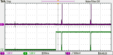

  • Hi JMMN,
    here are the plots of what happens when I try to connect a debugger...
    Note: Green line is a D+ line

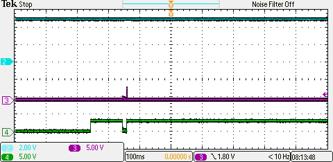

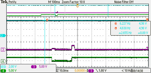

  • Well I can see that the USB 2.0 high speed handshake is attempted, but I can't determine why it fails. The most likely cause is signal quality or power. Please check that VBUS to the port doesn't dip during the handshake.
  • Here are the scopes with VBUS on channel 2 (blue one), but the voltage does not seem to clip...
