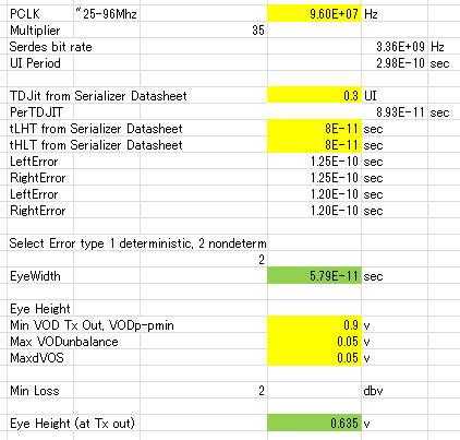

  • eyemask_estimate_draft.xlsxHello,
    The DS90UH929 is an FPD Link3 serializer normally used with STP differential output DOUT+, DOUT-.
    Using the 35 bits per symbol, and max clock input of 96Mhz, has a max serdes bit frequency of (35*96) 3.36Gbps.
    An external Clock and external Sync can be used with the Pattern Generator, to generate a video data pattern.
    8.3.18 Datasheet.  Also Application Note AN-2198.
    The reference I used is -
    In the datasheet, we don't have an eye mask, we have FPD 3 parameters in electrical characteristics.  see section 7.5, 7.6
    I have created a draft EXCEL, please look at it, and send questions.

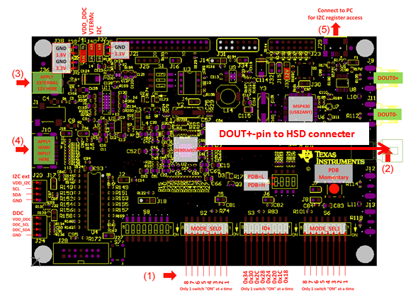

    There is a Tektronix reference for the DPOJET software.
    on page 39 of the EVM User Guide, if you measure DOUT0P and DOUT0N together check the part installation, or for SMA measurement you need to add resistors.  You need to make sure each line is terminated with 50 ohms to GND.
    Note: if you make SMA measurements, the eye height is 1/2 the total.
    The average cycle to cycle jitter, is needed.

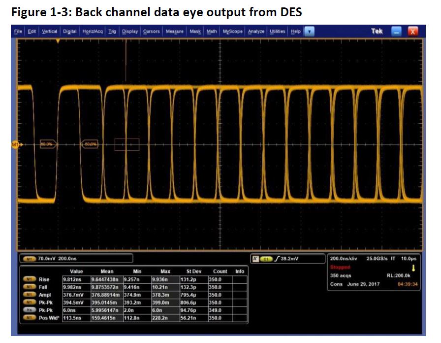

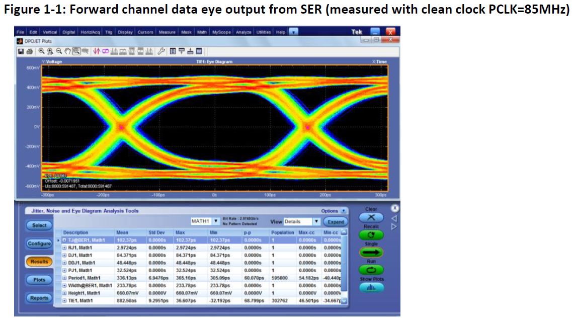

    In the case of the forward channel (Serializer Output - not connected to Deserializer, terminated at oscilloscope or termination board)
    In the case of reverse channel, I do not have an example picture, different oscilloscope metrics were used.
    See Deserializer_BackChannel_Example_OscMeasurement.10Mhzjpeg.
    Joe Quintal

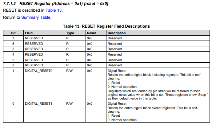

  • Hi, Joe
    I can't find "Back Channel Enable" register in DS90Ux94x series.
    Which register have this function?
    I can find "Back Channel Enable" register in DS90Ux92x series.
    Nao
    for DS90UB948, it is called Back Channel Enable for Camera Mode, reg x1.
  • Hi, Joe
    Which bit?
    Nao
  • Hello
    Back Channel Enable is a Deserializer Control Bit
    DS90Ux926, reg1, 0x01, bit2 ,BC Enable
    DS90Ux928, reg1, 0x01, bit2, BC Enable
    DS90UB948, reg1, 0x01, bit2, Back Channel Enable for Camera Mode (see the ALP tool register map)

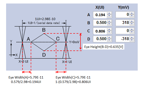

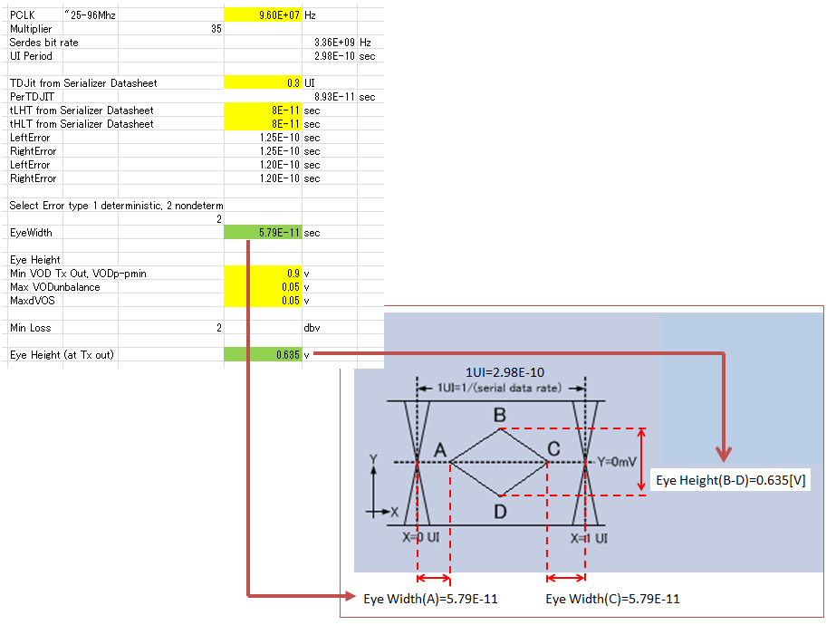

    I have a question about "eyemask_estimate_draft.xlsx".
    What does this parameter come from?
    Is this value "Rx In" or "CMLOut", if min loss is total loss to Rx of des device from Tx of ser device?
    Nao
    When we generate the Forward Channel output, there are losses from the device pin to the connector where you would measure the signal.
    These can be measured, using a network analyzer for S21 reflective loss, and S12 for insertion loss.  Those two conditions are combined in the Min Loss
    as the note in the spreadsheet describes.
    Joe Quintal

    Is this measurement done on the DS90UH929 EVM?
    Nao
  • Hello
    2db is a number to show the effect of reflective and insertion loss it is not an EVM value.
    This would need to be measured by removing the DOUT+ and DOUT- capacitors, and using a network analyzer check the Forward Insertion Loss, and Reverse Reflection loss from the signal.
    Note: a small additional loss from the DOUT coupling cap to the device would be added also.
    Joe Quintal

  • Hello Nao,
    The spreadsheet calculation is based on the user input.  While the fraction of UI will not change, the value is seconds will change by entering the customer PCLK value (for eye width)
    The spreadsheet value for eyeheight can be based on the spreadsheet method where we estimate the loss from the device to the output connector
    it has a user value for reflective and insertion loss of 2db.  This is a starting value for eye width.
    Note: If the customer FPDLink deserializer has a CMLOut, you can measure the receiver Forward Channel after AEQ is applied.  you want an eye height >= 100mv.
    Other than those comments its OK.
    Joe Quintal
  • Hi, Joe
    May I confirm your 2 comments?
    > We estimate the loss from the device to the output connector it has a user value for reflective and insertion loss of 2db.
    Is this here?
    Is this setting correct? PCLK is 96MHz which is orignal value of the calculat excel file.
    Nao
    The Serializer DOut pin , to coupling capacitor, to trace to stuffing option resistor, to connector for both P and N are the traces from the part to the connectors. If we have a 1db loss in the DOUT+ to connector, and a 1db loss from DOUT- to connector that is a total of 2db. This includes insertion and reflective loss.
    If you wanted to measure this you would remove the DOUT coupling capacitors and measure from that insertion point, to the connector, after removing the test equipment cable loss.
    If you change the PCLK you change the period and the UI time. You don't change the %UI. In your figure you have the same time, and a different UI value. It should be symmetric. It depends on your PCLK. You change it in the spreadsheet, it will calculate the new time value.
    Joe Quintal

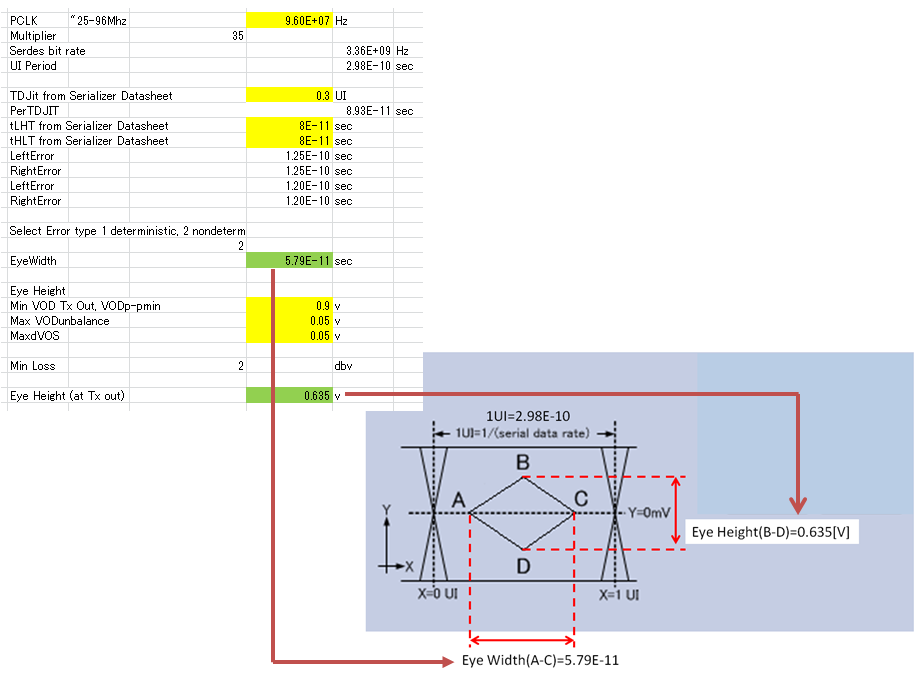

  • Hi, Joe
    I understand that how to measure min loss value
    Thank you.

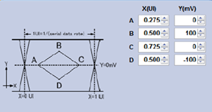

    Sorry for confused you about Eye mask.
    I would like to know which value of Eye mask the value calculated by Excel.
    Could you draw a Fig, if my understanding is wrong?
    Nao
    Eye Width is from A to C.
    Please look at "www.onsemi.com/.../AND9075-D.PDF"
    The reason it is a small value is based on the jitter + skew applied to the left and right side.
    If you have a different PCLK, the jitter value scales with the clock period, the skew does not.

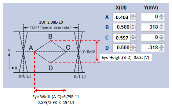

  • Hi, Joe
    Thank you for your quick reply.
    Nao
    Given that you have a 96Mhz Pixel Clock, and use 2db insertion and reflection loss, its correct.
