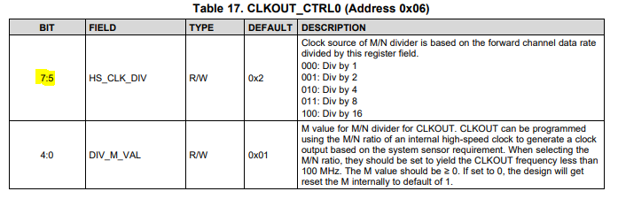

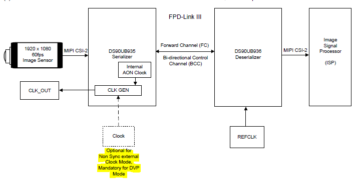

Our customer wants to consider DS90UB935 and DS90UB934 with DVP mode and CSI-2 non-synchronous CLK_IN mode.
According to the SNLA270A, UB953 and UB935 can not use CSI-2 non-synchronous CLK_IN mode in DVP mode.
However, according to the latest datasheet of UB953 and UB935, they can use CSI-2 non-synchronous CLK_IN mode in DVP mode.
We don't need to case this limitation now?
