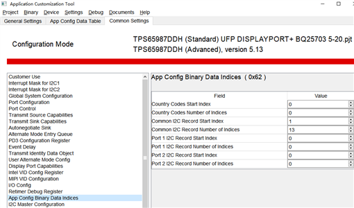

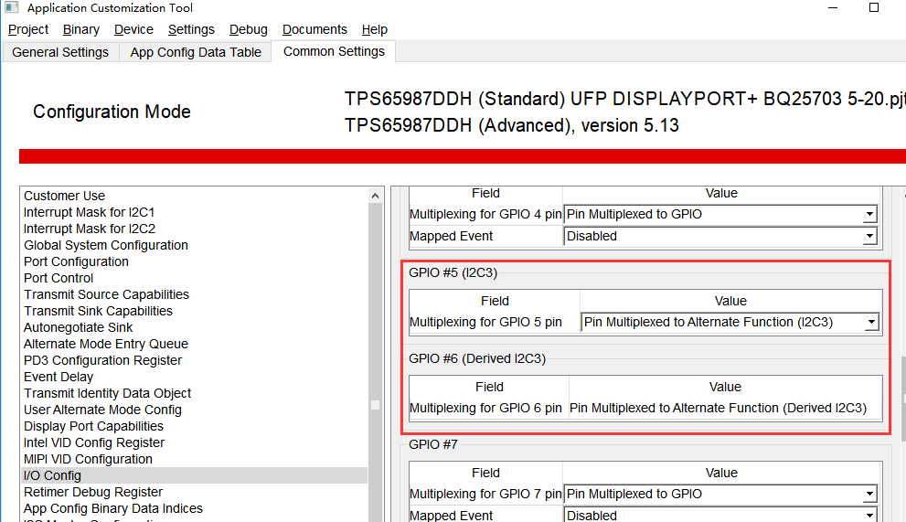

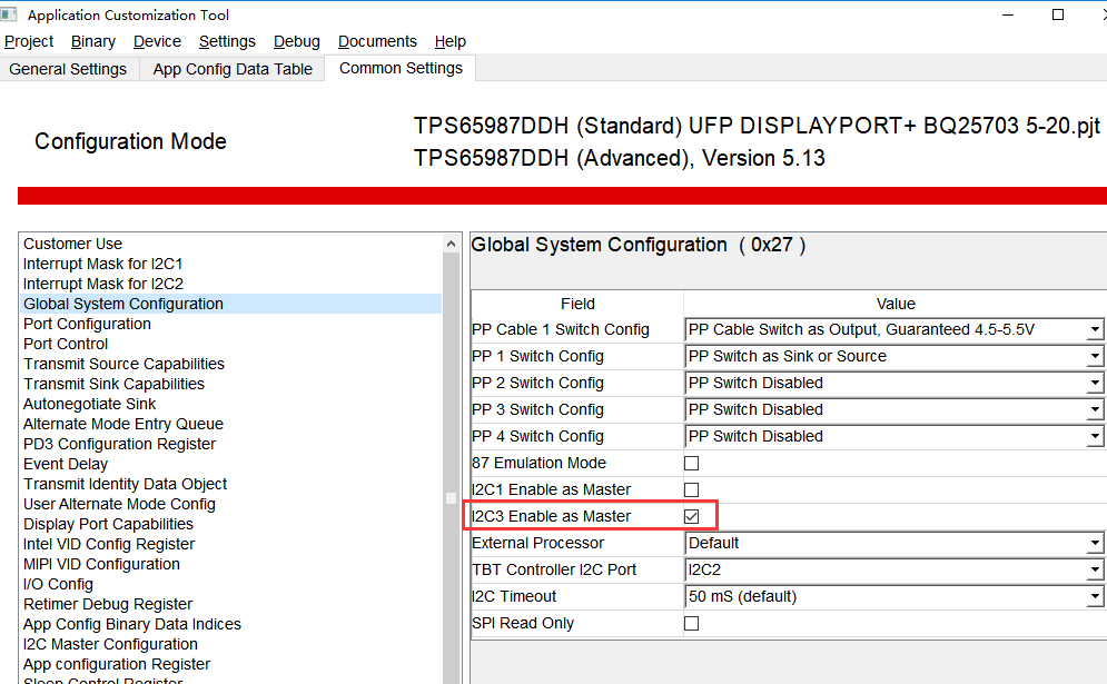

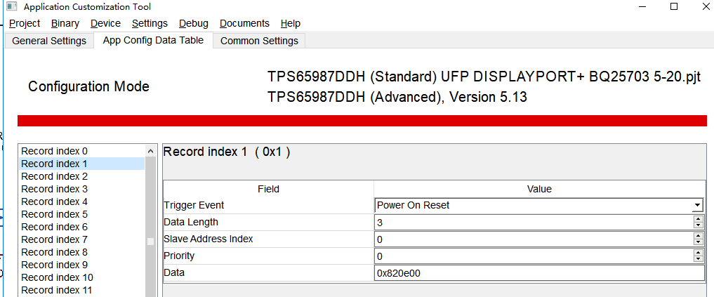

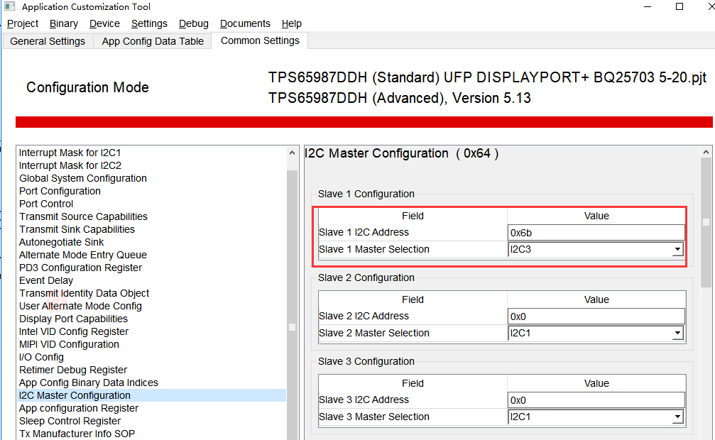

How to control BQ25703A  via the I2C3 of TPS65987D?
The I2C3 of TPS65987D is connected  to bq25703 in my design.
I have changed all the register according to the SLVAE18.pdf ,and set the I2C3 as master,but i can’t  see any waveform by the oscilloscope on the I2C3 scl & sda. Of course, BQ25703 is also not set successfully.
the current setting of my tool:
Please help us to solve this problem.
