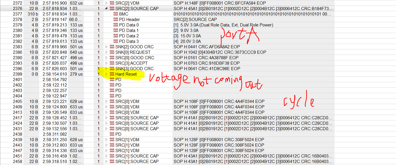

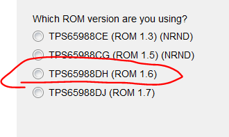

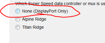

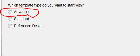

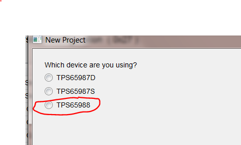

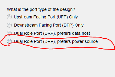

      I use below PJT file( follow default setting on 988 ), download related full image Bin file to 988EVM,  I find Port A is always negotiating, but PortB is ok. Please help to check. Test procedure,
    1. Power on the 988EVM.
     2. Keep default HW setting on 988EVM.
    3. download bin file to 988EVM.
    4. Connect a sink board to 988EVM port A, issue occurs, Connect a sink board to Port B , no issue.
     Please help to check. All the setting is same. for Port A and Port B.
   PD log
pjt file setting,
When I set pjt as follows , using virtual address to send the source cap, no issue on PortA.  It is too curious.
