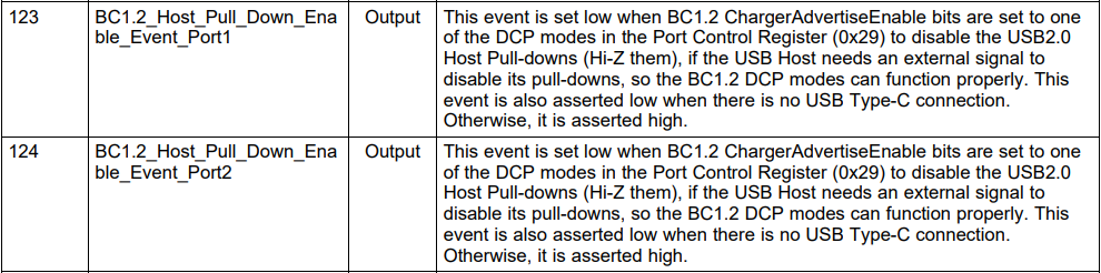

One of my customer engineers has the following questions regarding our TPS65987:
We are using the TPS65987 for a USB PD application, and using GPIO outputs from the part to tell a processor which PDO is being utilized.  However, we haven’t found a way to signal (via GPIO) whether the part has detected a BC 1.2 adapter or what are the current limits of the adapter.  Specifically, we would like to know if the connected adapter/port is capable of >500mA source.
Do you know if this is possible?  Any help you can provide would be appreciated.
