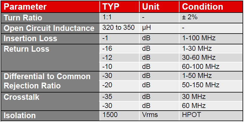

Can you please let us know if there is any guidelines for selecting magnetic's for DP83867. Currently we are using Wurth (7499111446) if this part will work.

I recommend looking at the magnetics used on the EVM and comparing datasheets. Use magnetics with integrated common-mode choking devices.

Thanks for update. Since Gerber has been released, So i want to understand quickly what concern may come. So that i can take a call on stopping fabrication of PCB.
Hello Abhishek,
This part will not work with this application as the center taps are shorted together. Each PHY side center tap must be isolated from another and decoupled to ground through a decoupling capacitor (0.1 uF recommended). I would find a different part that meets these requirements:
This information is planned to be added to the datasheet.
