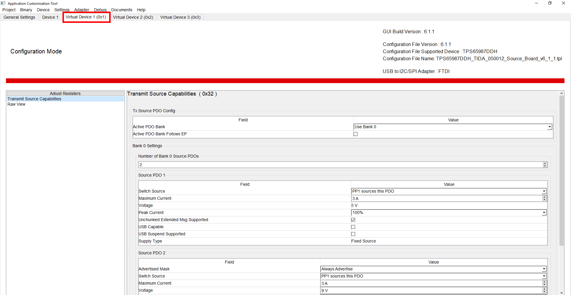

  • Hey Nathan,
    I would recommend downloading the following configuration tool. It includes the project file for the Power DUO Source and Sink boards. You can load these projects by clicking Project -> New Project -> TPS65987DDH -> TIDA-050012 Source Board. This is a great example of how to use the App Config functionality.
    http://www.ti.com/tool/TPS6598X-CONFIG
    First you create the number of virtual devices that you need for your application. Then for each virtual device, you create and assign an event either on the rising edge or falling edge of the signal to the GPIO. In the highlighted second image, the first virtual device is connected to app config group setting 1, and on a rising edge, the source capabilities are sent again on the CC channel with the new capabilities. For the GPIO setting, use 'Port 0 Load App Config x Event'

  • Then you can use the PWR DUO Sink configuration template as an example. Please refer to my previous post, but instead of clicking TIDA-050012 Source Board, you would click on TIDA-050012 Sink Board.
    You would the virtual devices to advertise its sink capabilities of going up to 12V

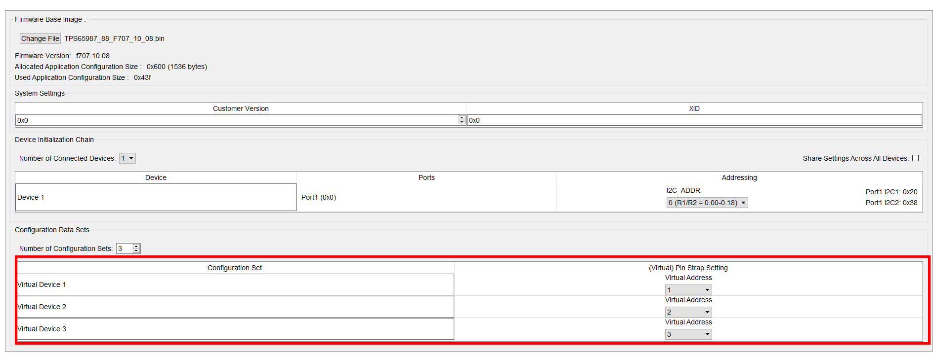

  • Hi Adam,
    I have referenced the TIDA-050014 Sink board design example and completed the swap voltage function (from 20V to 12V).
    We used  GPIO14 to trigger event signal from LOW to HIGH and created one virtual devices to advertise its sink capabilities of going up to 12V.
    We have some question for the examples of the TIDA-050014 Sink board design.
    1. After the function completed for swap voltage from 20V to 12V.
        Can we use the same GPIO14 to reduction swap voltage from 12V to 20V (trigger event from HIGH to LOW)?

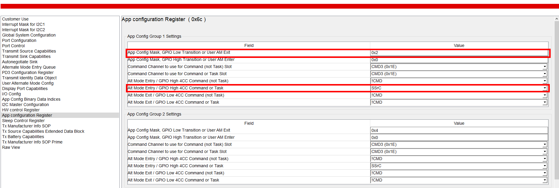

  • Hi Adam,
    Please help to confirm the setting in following graph.
    To building Virtual Device 2 (Mask 0x8) and set it up to App Config Mask, GPIO High Transition or User AM Exit. (Value 0x8)
    Then the PD is shutdown not any power output. When the system power on.
    [/quote]
    Nathan
  • Hi Nathan,
    Yes this looks correct and should accomplish what you are wanting to do.

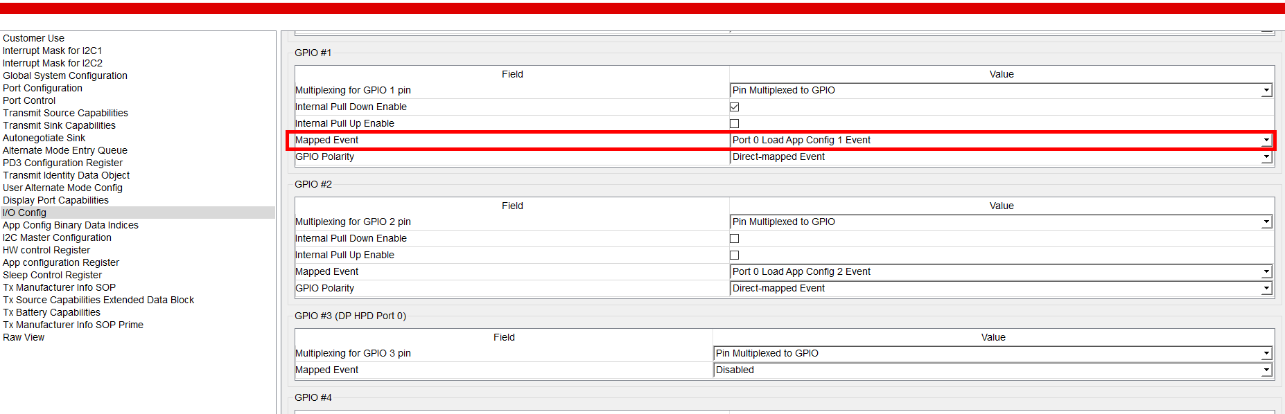

    We want to used one GPIO to swap voltage from 20V to 12V and reduction from 12V to 20V.
    Function status as below:
    1. GPIO14 --> set internal pull down --> Mapped event port 1 load app config 1 event "App Config Mask GPIO LOW Transition or User AM Exit" --> Mapped virtual device 1 (0x2)  <<<  20V ->12V function ready
    2. Set GPIO14 Mapped event , port 1 load app config 1 event "App Config Mask, GPIO HIGH Transition or User AM Exit" --> Mapped virtual device 1 (0x8)  <<<  12V ->20V  The system can't power on.

  • Hi Adam,
    We have two test result.
    Test A
    (App Config Mask GPIO LOW Transition or User AM Exit --> Mapped virtual device 1 (0x2)) 12V
    (App Config Mask, GPIO HIGH Transition or User AM Exit --> 0x0 )
    Step 1. flash new PD FW and plug-in type-C adapter to power on the system.
    Step 2. The GPIO14 "internal pull down" and make the GPIO14 signal from low to high from EC that the PD can swap voltage from 20V to 12V.
    Step 3. When the PD out voltage is 12V and make the GPIO14 signal from low to high from EC that nothing happen the PD output still is 12V.
    We want the voltage to return to its original state of 20V.
    Test B
    (App Config Mask GPIO LOW Transition or User AM Exit --> Mapped virtual device 1 (0x2))12V
    (App Config Mask, GPIO HIGH Transition or User AM Exit" --> Mapped virtual device 2 (0x8))20V
    Step 2. The PD controller The PD controller has no output voltage.
    So Can we switch the ouput voltage of the PD controlle from 20 -> 12 -> 20 to use a GPIO ?
    Nathan
  • Hello Nathan,
    Would you be able to use a separate GPIO for each event, similar to what the power duo board did? So instead of using the rising edge for one command and the falling edge for the other, you would use both the rising and falling edge for each configuration, having their own respective GPIO's
  • Hi Adam,
    Yes, I have used a separate GPIO for each event and follow the sink power duo board setting. but still have some question.
    1. When only one set of events (The PD default 20v output when system power on. Set event to GPIO14 to get 12V output). --> The function ok.
    2. To add a second group of events (The PD default 20v output when system power on).
    set the GPIO14 for 12V output.
    set the GPIO15 for 20V output.
    The PD 65987DDH do nothing. The VBUS is keep 5V.
    Do you have any suggestions for us to check for PD FW setting.
