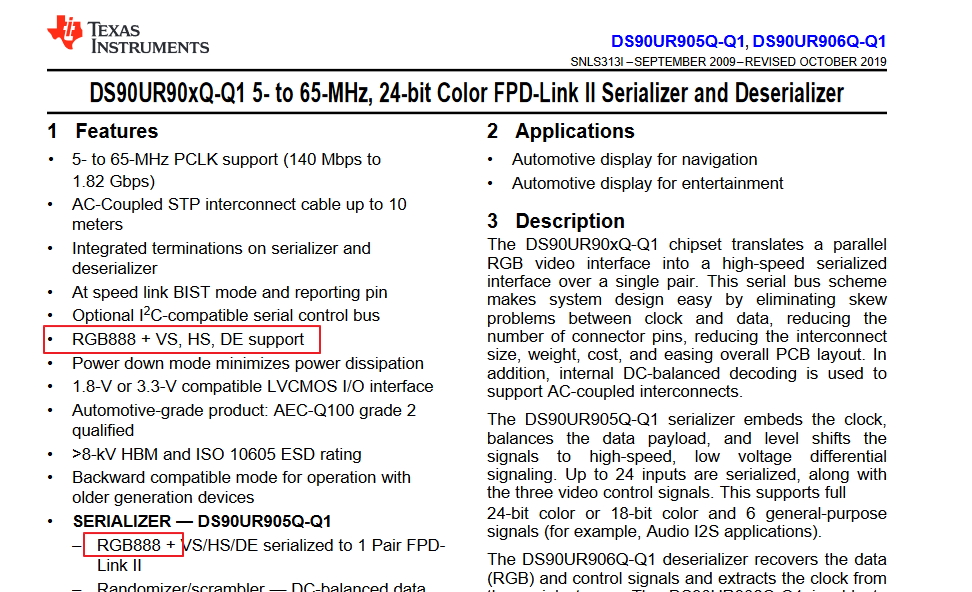

In the datasheet ,Input signal support RGB888,Does the input signal support RGB565?

Hello Neal,
905 can operate in 24 or 18 bit color modes but for RGB565 (16 bit), you can simply leave unused color input/outputs disconnected on both sides of the serializer/deserializer link
