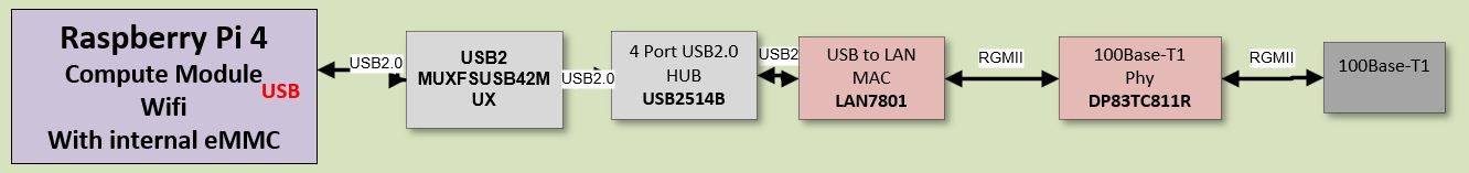

we are having a strange Problem with the DP83TC811R Phy
which is connected to a lan7801. The lan7801 is connected
to a raspberrypi. We are using the Phy in Master mode.
We are facing a reconnect issue if the connected slave
is disconnected and reconnected again then the connection will
*sometimes* not be reestablished.
The strange thing is that in INT_STAT2 always "Overvoltage"
and in INT_STAT1 always "ESD Event" is set.
Also the "No Frame Detected" in INT_STAT3 is set event
there is a connection established.
Why are there NoFrame, overvoltage and ESD interrupts?
Overvoltage and ESD is almost always present.
What does overvoltage mean here? The datasheet says it's VDD. Which VDD is this?
When do you get an ESD event?
Do you think these messages are connected to not being able to sync
after the re-connect from the external interface?

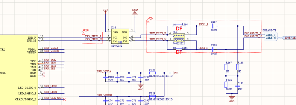

I also attached our schematic.
Thanks for your help.
Sven

Hi Adrian,
- As far as i can see, all other Parts are working correctly.
Michael
Hi Michael,
Could you try to reupload the image of the block diagram? I don't see it on the thread.
Adrian Kam
Hi Adrian,
thank you for drawing attention.
From DP83TC811 to the right side, the comment should be "100BASE-T1"
Best regadrs,
Michael
Hi Michael,
Try the following:
In addition, can you provide the full schematic? You can upload it to the thread or email it to me if it cannot be publicly shared.
Adrian Kam

Hi Michael,
Adrian Kam
Hi Adrian,
1. Yes, it looks as we had a ESD Interrupt on MDI side.
In my opinion, there are 2 scenarios:
- we have always an ESD event, which explains why there is always an interrupt pending, and the counter in register 0x0448 is not working.
or:
- we don't have an ESD interrupt, which explains why the counter doesn't continue counting, but the interrupt can't be cleared and is therefore pending.
I can't imagine, that me have everytime 64 ESD pulses that we can't see the counter working.
what do you think? did i forget to mention a possibility?
2. I made the measurments, but i haven't seen any spikes or overvoltage/undervoltage on MDI lanes.
Michael
Hi Michael,
Can you try removing the ESD diode array and see if the connection issues still exists? This seems to be the biggest difference between your schematic and the EVM.
Adrian Kam
Hi Adrian,
I tested already with removed ESD diodes, but without success.
We found out, that the MAC (LAN7801) detects sometime a RUNT Frame from PHY after disconnecting the "Slave" device. Everytime this occurs, our Board isn't able to reconnect without a reset.
Do you have any idea where these could be coming from?
Michael
