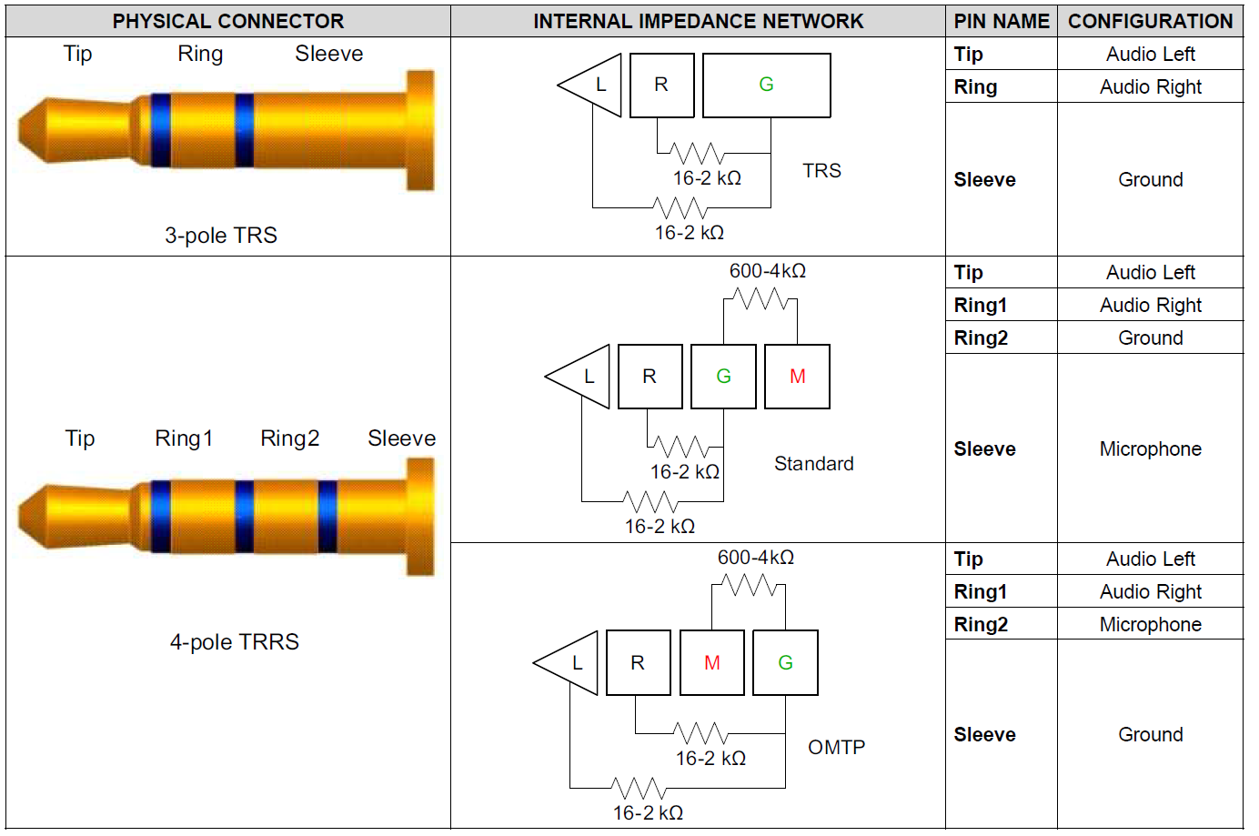

    Your circuit shows similar functionality i want to do with my project. I made a concept of my project with your recommended chips. My circuit should do the following things:
    1. Detection of the device which is connected on the USB type C jack (Is it an audio device or a USB 2 device or a power sink)
    2. If it is an audio device: Detection which audio device is connected (microphone, speakers, headset, etc.)
    3. Power Delivery function due to USB specification
    In attached circuit you can see my concept.
    Do you think it is possible that an USB 2 - host (for example a notebook) which is connected at the USB 2 B jack on Board A can detect which device is connected at the USB type C jack?
    Thanks!
    Mustafa
  • Mustafa,
    The TPS65982 will detect the impedance on the CC/Vcom lines to determine what type of accessory is detected.   One of the TPS65982 GPIOs can be configured to switch the TS5USBA224 to an audio path if the TPS65982 detects an audio accessory.
    The TS3A227E will run a detection algorithm using the tip, ring 2, and sleeve nodes of the audio device to determine if it is a 4-pole or 3-pole device and then automatically switch the ground FETs appropriately depending on where the audio accessory ground is .
    You can refer to the TPS65982 EVM for more information.
    Yes, based on the TPS65982 detection algorithm of the CC pins.
    Thank you,
    Adam
