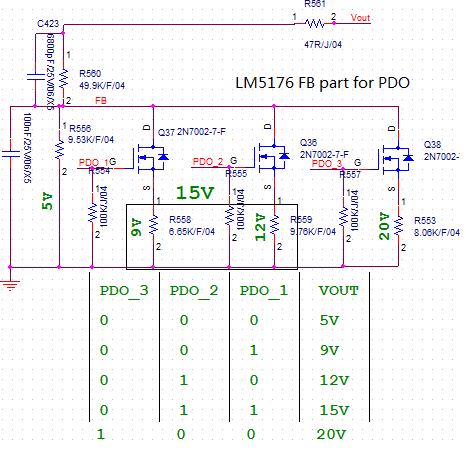

Hi.
i have some quetion by this part(TPS65987D).

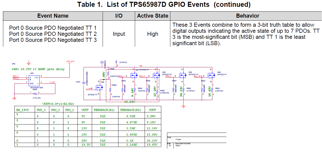

1、If we base on TT Mode by design PDO(becuase referece Design for 4pcs PDO-5,9,15,20V;we need 5pcs PDO-5 9 12 15 20V) ,is it add decorder(3:8) ?
or as below design?or other referece design at TI side? or like the TBT3 design TT mode(MP2491C include decorder)?
2、are these have the PDO voltage sequence(ext,default:5 9 12 15 20),are they change to 5 9 15 20 12V ,is it support ?

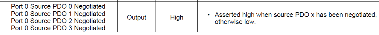

3、are they running TT Mode(true table mode),all PDO pins at low if no PDO mode?
4、How many PDOs for deafult on the TPS65987D ? and which GPIO pins setting it better? are they reference the EVM design is OK?
