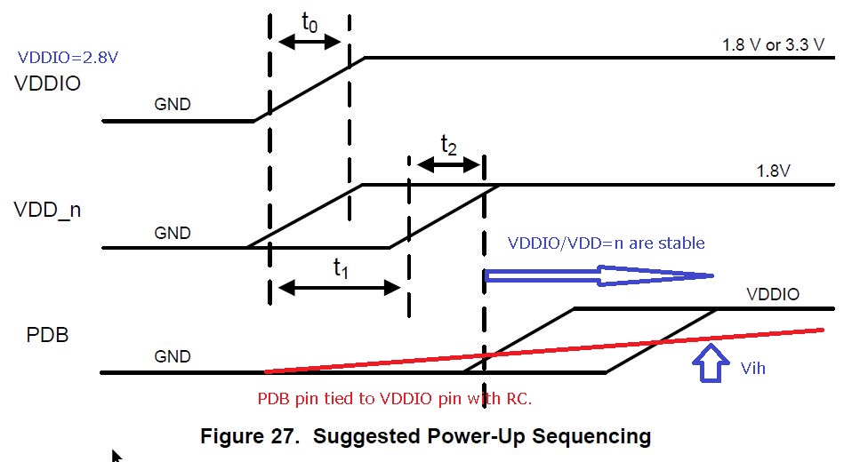

I'd like to confirm the "Power-Up Requirements and PDB Pin" in the new Datasheet.
IF the PDB pn tied to VDDIO with RC, It will ramp up with VDDIO whth the same time "t0" as bellow;
Is the PDB ramp up(Red line ) OK  for the device ?
Of course, the PDB pin will reach Vih after VDD are stable.
