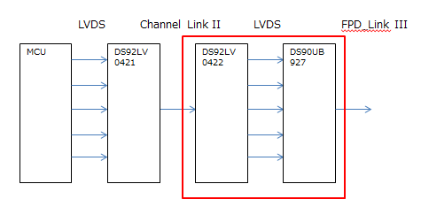

Our Customer is considaring DS92LV0421/2 and DS90UB927/928.
They want to connect DS92LV0422 and DS90UB927.
1. Is DS92LV0422 OK to connect DS90UB927Q-Q1?
2. Is there special register setting except for MSB or LSB setting?
