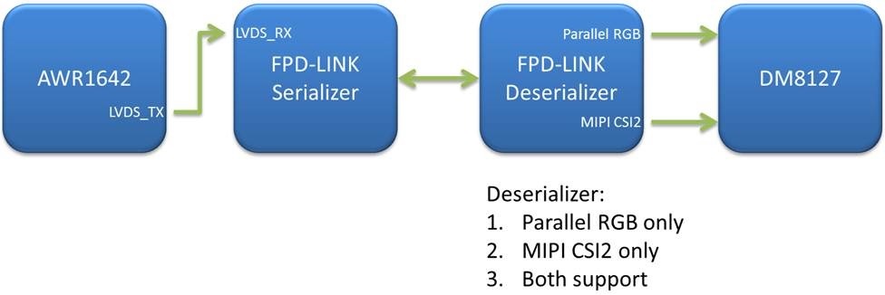

Hi all,
I want to find FPD-LINK solution for AWR1642+DM8127. Here is my block diagram:
Please give me some advice about FPD-LINK solution.
1. Serializer: LVDS interface
2. Deserializer: Parallel RGB or MIPI CSI2 or both support
Thanks in advance.
B.R.
OC
  • Hello OC,
    We have not tried out the a direct serializer option with AWR1642 since its mostly intended to be a single chip sensor with just a CAN kind of interface for final object data transfer.
    You could possibly use an FPGA to convert the LVDS signals to CSI and then DS90UB953 serialzer to send the CSI data with DS90UB954 deserilizer.
    Vivek

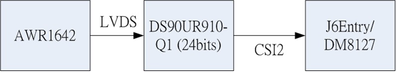

    Please help to confirm if I want to use DS90UR910 between AWR1642 and J6Entry or DM8127 that is ok or not.
    B.R.
    OC
  • Hello OC,
    From the DS90UR910 datasheet it does not look like it can directly take the LVDS input from the 1642 device. I would suggest clarifying the details about FPD devices from the High Speed Interface E2E forum
    regards,
    Vivek
