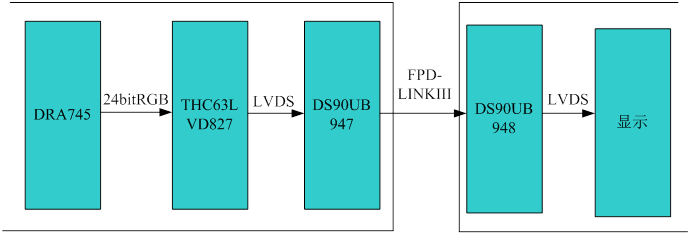

Secondly, during the PP testing in Cars the Infotainment will happen snow dot in screen or screen will change black.
The design's org as below picture(DRA745 sends PCLK is 148.5MHz and RG888 signal for the requirement of 1080p@60HZ):
The specific issues as follows:
  1. The first issue is screen has back light, however, screen has no image. And the LOCK pin of DS90UB948 is always low level.
             So we set off PCLK of DRA745 and set on PCLK again, there is no image. Then software reset DS90UB948 and DS90UB947, there is no image either.
        2. The second issue is screen has back light, however, screen has no image. And the LOCK pin of DS90UB948 is always high level.
             So we set off PCLK of DRA745 and set on PCLK again, image is OK.

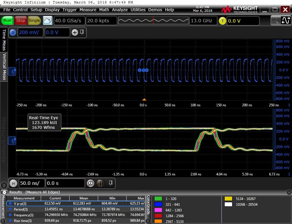

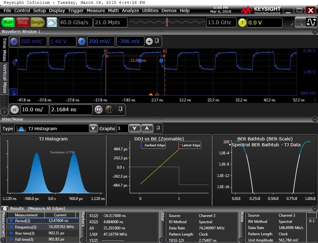

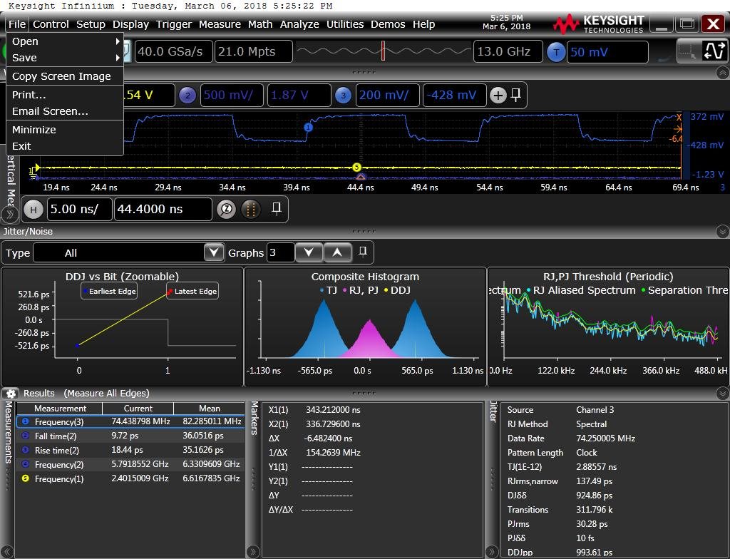

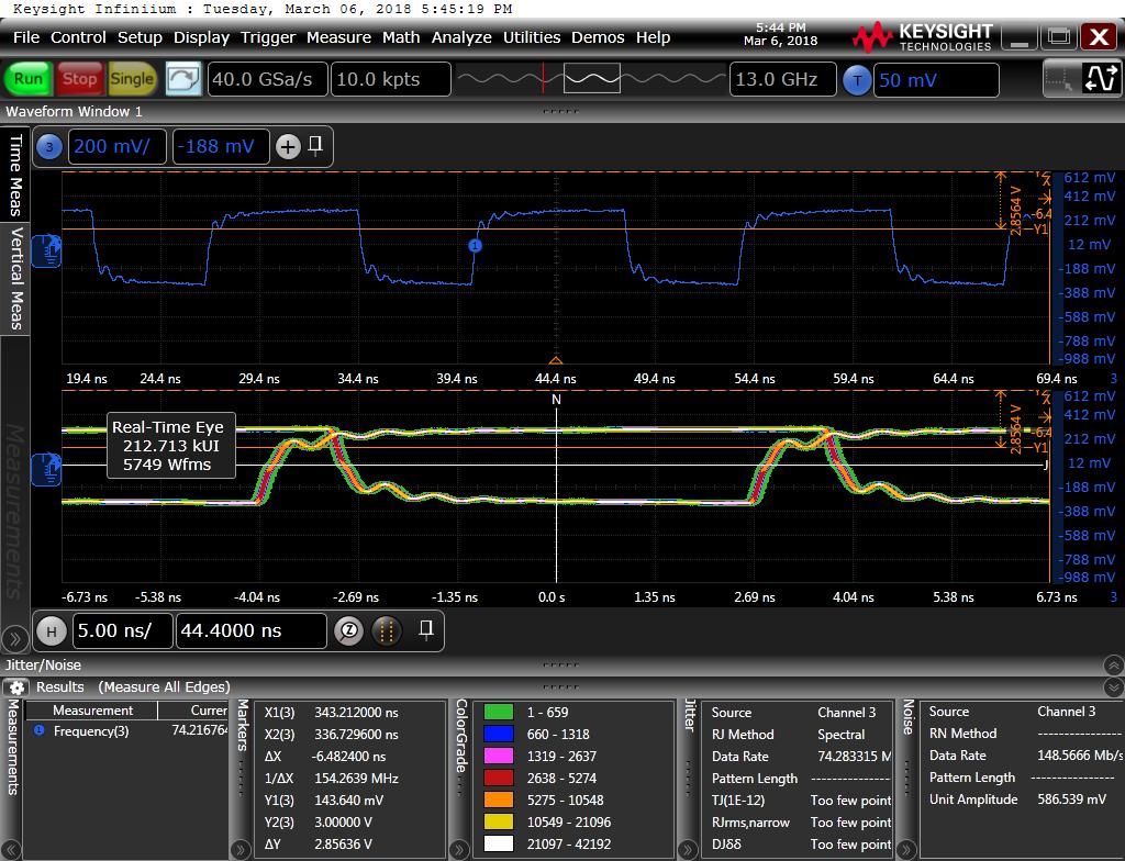

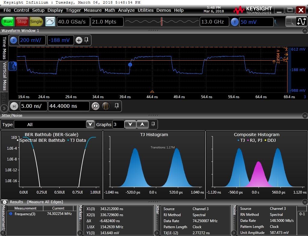

  2. We compared the DS90UB947 LVDS CLK’s jitter and eye diagram between the bad board and good board as the below pictures.
a) Good board's eye diagram:
b) Good board's clk jitter:
c)No image board's eye diagram:
d) No image board's clk jitter:
e)No image board's clk jitter:

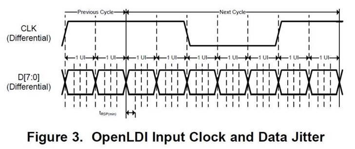

Btw, there is other question about clk jitter:
From datasheet of DS90UB947 OpenLDI Inputs as below pictures. The time of 0.2UI is 348.8ps and we want to know the paramate of Input Total Jitter Tolerance whether is only LVDS CLK's jitter or the jitter between CLK and Datas?
    (2) Includes data to clock skew, pulse position variation.
    (3) One bit period of the OpenLDI input.

  • Hi Luck,
    From your issue description, it seems many issues are involved together, please:
    1. when issue is reported, please measure the LOCK indication of UB948. if it is low, please check whether it has data output in the high speed channel?
    2. when LOCK has high and low translated signal, please check the link signal integrity, such as PCLK that you had measured, and cable / connector qulality, etc.
    3. please check the chip part number, and your detailed test conditions, such as temp.? power on sequence? failure rate?...
    btw, what is your customer? if possible, please contact with your local FAE.
    best regards,
    Steven

    And could you kindly help to give advice about the below issue?
    Thanks a lot!
    Best regards
    Luck Wu
  • Hi Luck,
    the skew between clock and data is well but please note the total input clock jitter spec., which should be <0.2UI@OLDI bit period (combing the variation due to environment). But as you should know the less the more margin in your system design.
    best regards,
