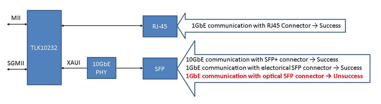

Though my customer is trying to communicate with 1GbE via optical SFP connector, it doesn't go well.
On the other hand, communication with 1GbE via electrical connector(RJ-45 and electrical SFP) and 10GbE via optical SFP connector goes well as below.
Electrical SFP connector is LFP415.
Is any procedure or setting needed to communicate with 1GbE via optical SFP connector?

  • Hi Kuramochi,
    Could you provide the procedure to configure the TLK10232 to interface with SFP+ optical module? Basically, this device is intended to interface with backplanes, hence, if the device is going to interface with optical modules, the Auto-Negotiation and Link Training features must be disabled. And a tuning for SerDes settings should be performed.

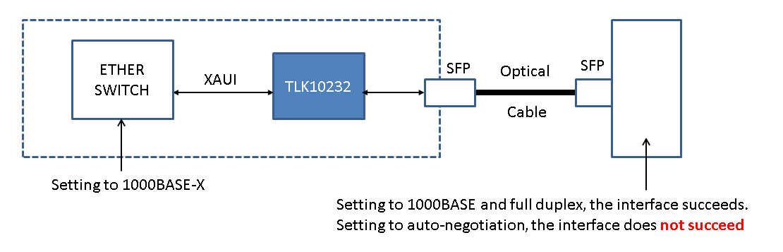

  • Hi Luis-san,
    Thank you for your advice.I understood the case of 10G-KX.
    How about the case of 1000BASE as below?
    My customer's requests to interface 1000BASE-X with the auto-negotiation. However it doesn't go well as above.
    Is there any way to interface with the auto-negotiation through 1000BASE?
    Kuramochi

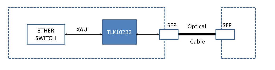

  • Hi Kuramochi,
    Could you attach the block diagram again, please? I'm not able to see it.
    Luis
  • Hi Luis-san,
    Thank you for your reply.
    I attach it again.
    Kuramochi
  • Hi Luis-san,
    How about this situation?
    Kuramochi
