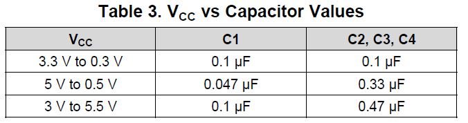

    What cap valuex did the customer use for C1-C4? I assume they're 0.1uF since the supply is 3.3V.
    Maybe you can try use another option, C1=0.1uF and C2, C3, C4=0.47uF. By doing this, the output voltage ripple will be smaller. It might help current spike as well. Please let me know if it woud work.
