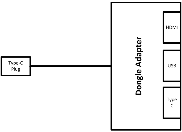

The first method is mainly used in a DisplayPort  supported dongle application where there is generally one Data Port (USB Type-A), one video port (HDMI/VGA/DP), and a source of power (Barrel Jack/Type-C Charging Port). The figure below shows a typical Type-C PD dongle design.

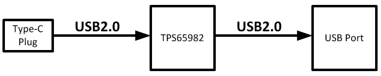

The TPS65982 in a DisplayPort supported dongle can be connected directly to the Type-C plug USB2.0 signals. In normal operation, the USB2.0 signals will be passed through the TPS65982 through the USB_RP_P/N to the USB Type-A port. The figure below shows the USB path from the Type-C plug to the TPS65982 to the USB Type-A connector.

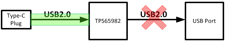

When the dongle is connected to a notebook that does not support DisplayPort, the TPS65982 will close the USB_RP_P/N path and expose the end point. This will allow the TPS65982 in the dongle to billboard to the non DisplayPort notebook that a DisplayPort device was connected. The image below shows the path when connected to a non DisplayPort system.

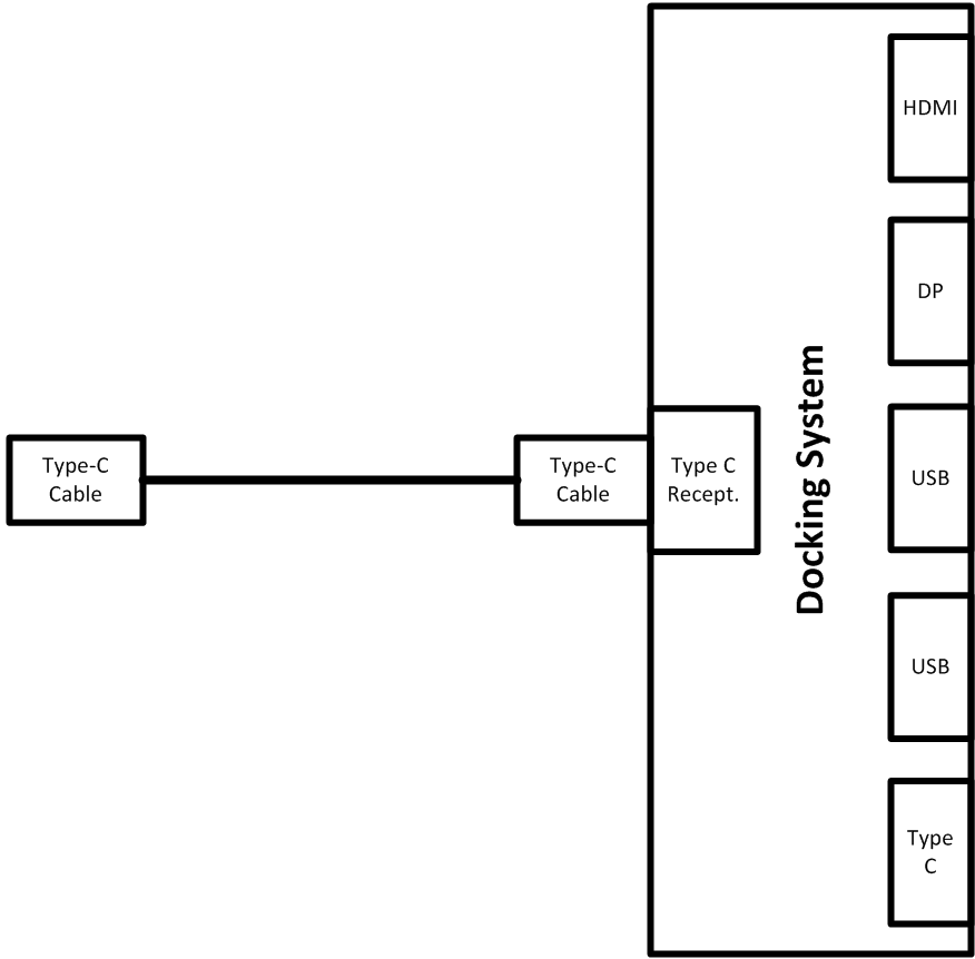

The figure below shows a docking application that has multiple USB and Video ports. This can also be extended to a monitor or a display application where DisplayPorts signals are connect to the monitor directly.

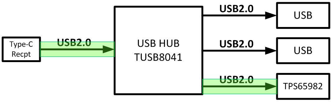

For a docking application where there is a USB hub for multiple USB ports, the TPS65982 is connected to the one of the USB Hubs DFP Ports in order to maintain USB functionality when connected to a non DisplayPort supported notebook. The figure below show the path when the the endpoint and billboarding function is enabled.
