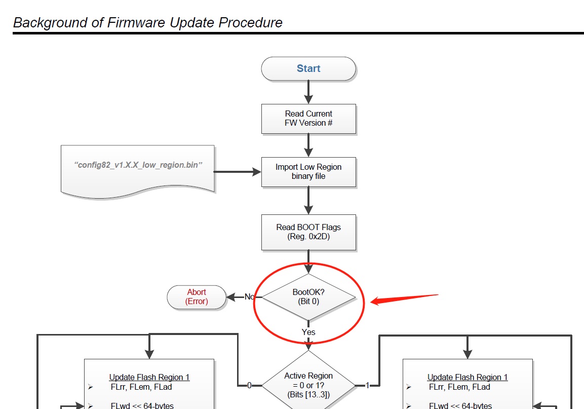

Now we use TPS65982 develop PC product, and there are some question about PD fw update in windows10 or UEFI shell.
we have read the document of <TPS6598x FW Update From Embedded Controller Over I2C>, and follow the flow chart to programing
but the result is fail.
And the step was:
1, Read Current FW Version. the result is correct. for example, 0xF4.01.37.90.
2, Read BOOT Flags(Reg. 0x2D) and juge the Bootok bit,but this bit always is 0.
so my question is why this bit is 0? and I have read the operational state of the device(Reg 0x03), the result is APP mode,

    Where did you get the firmware patch vF401.37.90? The firmware for 982 will have a version like 1.12.xx. Please use the 64kB low-region binary as input when updating the sFLASH over I2C.
    Book-OK '0' means the boot has failed, and I'm reluctant to use your register reads for any debug 'coz the device's version number is wrong to start with. First program the device w/ a full-flash binary, and then use the low-region binary to update the sFLASH over I2C - We can then review your observations.

  • Customer cannot define firmware version of PD controller - TBT and PD image coexist in the platforms NVM, and that's not an issue. But I'd expect to see the right firmware version and status. Please read 0x03, 0x0F and 0x2D, and share the information for me to investigate any further.

  • Can you please share the binary file that's programmed on the sFLASH, and also the low-region binary that you're attempting to update over I2C.
