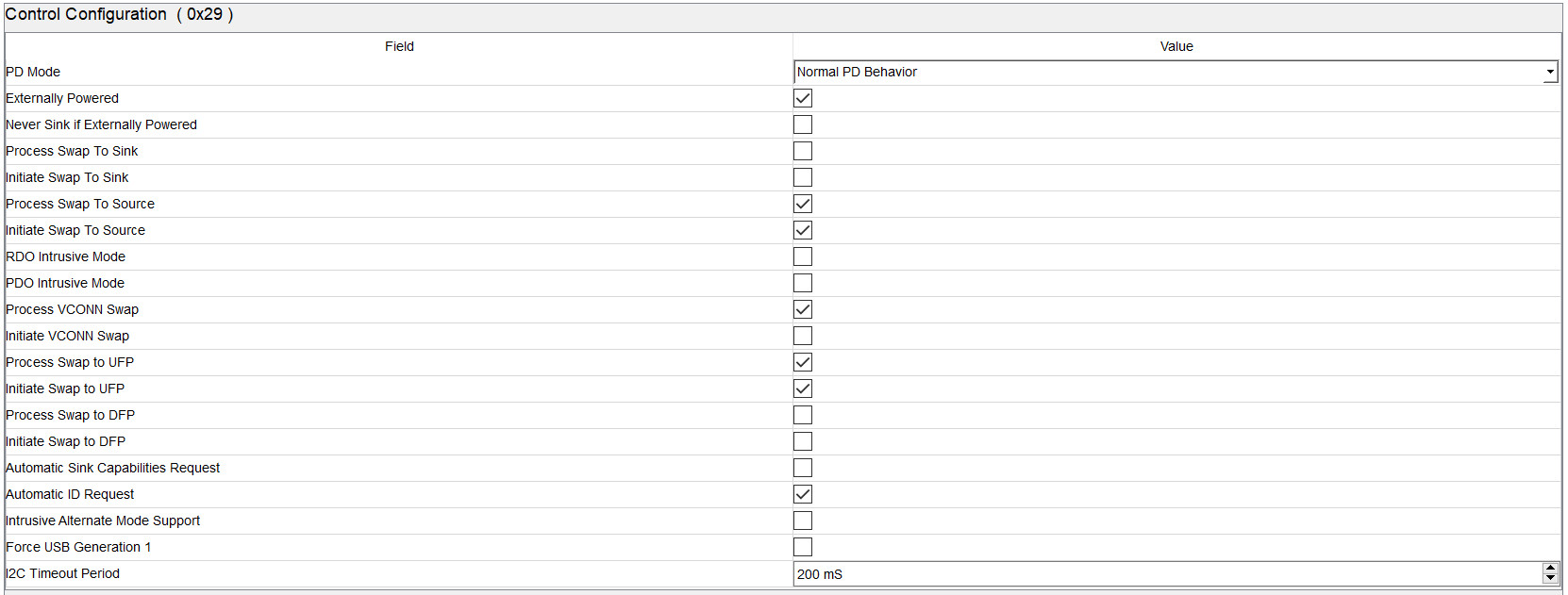

    Attached our 0x29 setting, please kindly teach us how to adjust.
  • Daniel,
    Please uncheck 'Automatic ID Request' in your configuration, generate new binary and reprogram on the platform. Please connect w/ your local TI representative (Takashi-san?) to learn about this process.
    -/Praneet
