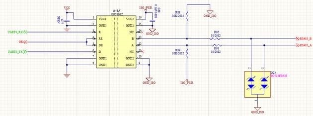

There is 2 questions about communication error(7MHz~11MHz)
1. Is there any issue in the schematic?
2. With adding 120Ohm resistor, can it support 32 nodes?
communication error waveform
Schematic
Adding 120Ohm for 32 nodes
Regarding the waveform, could you please confirm what waveform is this? Is this a waveform at A with respect to GND2, B with respect to GND2 or the potential difference between A and B?
Could you please also confirm the time-scale and the also the input signal applied?
ISO3082 only supports about 200kbps (100kHz) of datarate and communication at 7-11MHz wouldn't be achievable with ISO3082. For support upto 20Mbps (10MHz), you can use ISO3088.
I couldn't the values of components in the schematic clearly but it looks good. Please make sure the protection circuit on the bus is designed according to customer EMC requirements.
120Ω termination is needed to avoid reflections in transmission line for error free communications where there are multiple nodes on the bus that are located at farther locations. The schematic with 120Ω termination added looks good too. Yes, this will be able to support devices upto 32 nodes.
