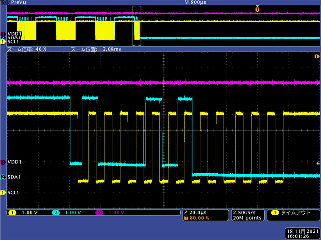

    Expanding figure from Start condition from microprocessor to 9th bit of SCL
    Blue: SDA1
    Yellow: SCL1
    Purple : VDD1
    FYI : In schematic I attached yesterday, I replaced FL1's ferrite to 0ohm resistor Bob advised me to do so.
    If you have any comments or advises, let me know.
    Toshihiro Sakakima

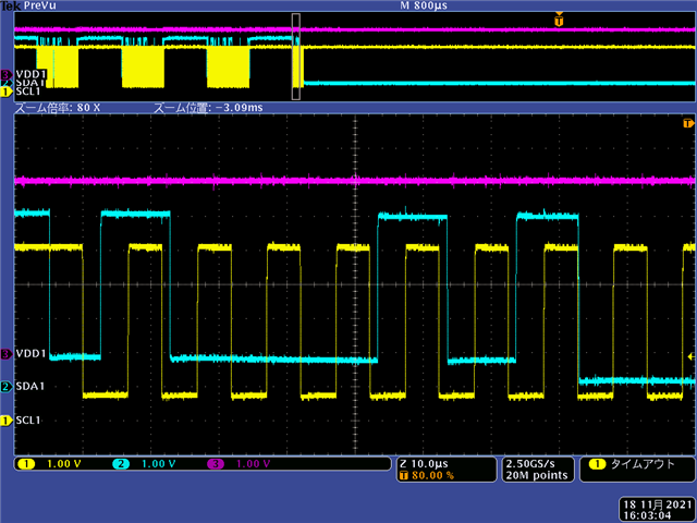

  • Hi Rao-san,
    Thank you for your reply.
    The issue is ADC IC fixed SDA at low level(=0V) after 7th clock of SCL was issued and stopped communication.
    At this time, the reason isn't clear.
    Now I attached the figure when communication success (This figure shows the result operated in fast mode 400kHz).
    See below figure.
    I think you can find the difference after 7th clock of SCL.
    When communication between ADC and MCU success, we can see SDA is about 0.7V because MCU(side2) sends LOW level in SDA at 8th clock of SCL.
    At 9th clock of SCL, ADC in side1 of ISO1640 sends ACK to MCU then you can find SDA equals about 0V.
    After 9th clock of SCL, ADC release SDA line and SDA becomes high level.
    That's the correct operation.
    However, at communication fail, we can see SCL becomes LOW(=0V) after 8th clock of SCL and fixed low level(i.e., ADC IC pulls SDA line to 0V).
    That's the issue.

  • Hi Sakakima-san,
    Thank you for clarifying the failure signature and clearly explaining the exact fail condition. I understand the issue clearly now and what you are saying makes sense.
    I can also see that ADC is pulling SDA1 pin LOW at the 8th clock and after that it is held LOW by the ADC and the ADC is not releasing SDA1 pin. Thus, further communication is not happening. With that explanation, it doesn't look like the ISO1640 is causing any problem. You might have to work with the ADC team to further debug the cause for ADC holding SDA1 LOW continuously.
    If you are not convinced that ISO1640 is working fine then you can probably monitor SDA1 and SDA2 together at the same time and see if the logic levels are matching and if isolator is correctly transmitting them. This clearly confirms if ISO1640 is working fine.
