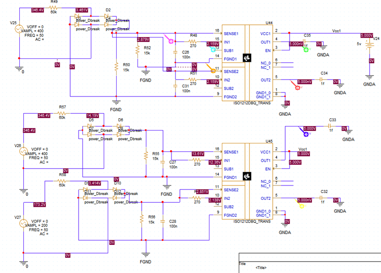

    I tried to do the SCH regarding the documents you mentioned. my simulation doesn't work because I have some floating pins that according to the datasheet they can be left floating. on the other hand I'm not sure about the design. Can you take a look and tell me if it seems OK or not?
    Thanks in advance.
    Farzaneh

  • Hi Farzaneh,
    Thanks for sharing the schematic.
    I took a look at the schematic, please see my comments below. Thanks.
    1. The FGND1 of U44 doesn't seem like has a return path, this part of device might not function. Maybe you meant to short it to FGND2 of U44.
    2. The schematic of U45 looks good.
    3. I believe you meant to have 15kΩ for R50, R52, R55 and R56 instead it is currently specified as 15Ω. I guess this just a typo.
    4. V24 is mentioned to be 6V. The device supports a max voltage of 5.5V, please reduce this value to 5.5V or lower.
    5. I see that you have used RSENSE (R48, R51, R53 & R54) value of 128Ω. The device has been characterised for values from 200Ω to 562Ω. Hence, please use a value between these. Using a lower value can lead to thermal issues.
    Koteshwar Rao
    Thanks a lot for your response. I changed my circuit to this one, according to your comments and also the EVA doc below: "">www.ti.com/.../sllu254a.pdf
    In all the outputs I just see 0 voltage.
    I can't find the problem!
    Farzaneh

  • Hi Farzaneh,
    Thanks for updating the schematic. I still see some concern in the the power supply to VCC1. The resistor divider will not be able to bring down the voltage and supply the isolator reliably, it is prone to loading. For example, any current flowing through R59 will increase the voltage drop across itself and then drop the voltage at VCC1. This could lead to device being turned OFF.
    Could you please change V24 voltage to 5V and retest again?
    Please do also share us the simulation file that you are using and let us know what simulation tool you are using. We can try to replicate your problem and debug. Thanks.
    Koteshwar Rao
  • Hey,
    I changed it to 5v, still nothing. Simulation and SCH have been attached. I use ORCAD.
    sim.rar
    Farzaneh
  • Hi Farzaneh,
    Thanks for sharing your schematic!
    I replaced the full-bridge rectifier with 4 diodes because the sub-circuit is not included in the file you shared.
    I also removed the AND2 logic as its version conflicts with my local library version.
    I ran the simulation and found that all the outputs are zero as you mentioned.
    Then, I found that the Vcc1 net alias wasn't defined or accidentally removed from U44.
    I added the net alias on the U44 VCC1 net so that U45 now has a 5V supply.
    With this fixed, The out1 of U45 goes high to 5V as shown in the purple curve.
    If I lower the VAMPL of V26 to 200V, the output goes to 0V.

  • Hello Alferd,
    yeah I could see that it was working. thanks a lot. But I have a question. As you might have read my purpose of using this chip at the beginning, I need to detect the three phase on my board. I was thinking of using this chip and then adding the outputs to an AND gate. Let's say I need to have all the lines "1", but in U44 both of the outputs are 0, although both supplies are 400VAC but I get 0 in both outputs. How can I fix it?
    Farzaneh

  • Hi Farzaneh,
    For U44, in1, in2 and sense1 and sense 2 are connected to the same source. Hence, they are drawing 2X current from the source.
    In order for U44 to be able to detect the current at 400VAC, you will need to reduce the R49 from 60k to 30k.
    Alfred
