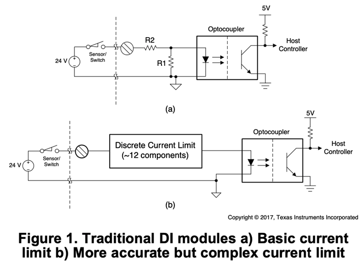

    As explained in the tech note that I shared in my previous post, current limiting is presently done in 2 ways. One way to use a simple series resistor and the other way to use an external current limiting circuit (with about 12 discrete components), as shown in the diagram below. The first approach doesn't regulate the current and it varies as input voltage increases. This is a big limitation as it demands for high wattage external resistors and increases overall board temperature limiting the number of channels that can be used on a single board.
    The second solution improves the situation significantly but requires lots of additional components per channel. The ISO1212 integrates all this circuit and offers better current regulation than these two solutions. That is the advantages of ISO1212 and many customers are able to integrate more channels on a single board because of minimal external components and good thermal performance. Please do share the tech note with customer so that they understand the benefits of ISO1212.
