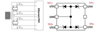

Hi Sebastian,
In this scenario there are a few connections made between a couple of boards before the magnetics are introduced and the intent is to help limit any issues on those assemblies. There is basically not enough room next to the connector for the magnetics but there may be for ESD protection.
Dom
Hi Dominick,
Could you please provide a schematic so I can give a better recommendation? For primary side ethernet protection we would recommend connecting the diodes as shown below for line to line protection:
A device like ESD204 could be used here.
