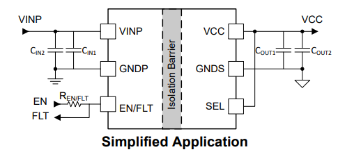

Does the EN pin can connect to VINP through 18KR directly? thanks

Yes, it can.
If monitoring FLT triggered: Connect EN\FLT pin to VINP pin through a 18.2kohm.
If monitoring FLT is not required: Connect EN\FLT pin to VINO in directly.

Jimmy,
Do you mean VINP?
VINP is the pin located at the top left side in the schematic shown above.
