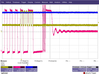

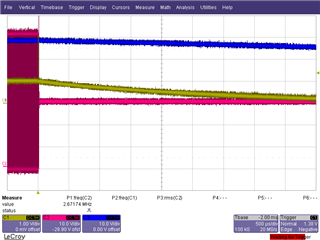

    thank you for your reply, measurement from the power lab / with power circuit will take longer time, but I was able to reproduce this behavior with a function generator. I couple a sequence of 7 pulses via capacitor 100nF with frequency 1MHz to the CLK input. With this sequence (scope picture), it latches every time, every time clock signal drops to 0V - input voltage cycle is needed to unlock it. I assume this or something very similar (in number of edges crossing the logic levels) happens in our converter.
    In scope pictures below - C1 clock signal(yellow), C2 SW output, C3 secondary side voltage, after rectifier (30V)
    - both plots show same event, just different time base
    Question is, what counter measures can you suggest? Is there something else then capacitor to GND which I can do? I will double check the layout, but already now resistors and return are placed as close as possible to the IC.

  • Hello Michal,
    Thank you for the clear details on this debugging process. I think we can say that the issue is related to the pulses applied to the CLK pin during operation.
    Its a bit disappointing that the auto transition from external clock to internal clock doesn't work in this case, as stated in datasheet (8.4.4), isn't this a bug?
    I understand your disappointment, however, I do not think it is a bug rather an edge-case. The automatic switch from external clock to internal switching described in 8.4.5 External Clock Mode is for use cases where the CLK pin is driven by an external MCU. The SN650x will switch to the internal oscillator if the MCU CLK signal is stopped.
    However, this feature is overridden when the CLK pin is connected to RCLK, and an external clock signal is no longer an option.
    The possible countermeasures would depend on the source of the "false clock" noise. Regardless the best solution would be to identify the noise and prevent it from propagating to the CLK pin. Would it be possible to remove RCLK and operate at the default switching frequency? This can be tested by either removing the resistor or lifting the CLK pin.
    Otherwise, the first thing to try would probably be an RC filter like you suggested. Another possibility would be using a ferrite bead. However, please monitor the switching frequency to make sure the effective resistance of RCLK seen by the CLK pin is the same.
