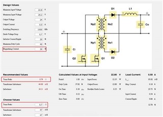

  • Thanks. Regarding to the PUSH-PULL There are a few more questions I would like to ask for your help
    1..Why do I calculate the number of turns on my transformer with the Power stage design tool that is so much worse than the formula given in the SN6507 specification? Is it because of the control method? (The specification is open-loop duty control, and the default control mode for the Tool is?)
    2.transformer excitation current Magnetization current has a recommended% number?

  • Hello Brian,
    Please, can you let me know which equation you are using in the datasheet to calculate the turns ration of the transformer? As well as the value in your tool?
    The transformer turns ratio calculated by the tool that I have access to comes out fairly close to your 2.209 number (online WEBENCH Power Designer).

  • Hello Andrew,
    1. Customer is using below equation for Nmin that is specified in d/s.
    2. Please find the below customer conditions. It looks the below result is different to what Webench calculated?
    Webench: turn ratio: 2.20
    POWERSTAGE-DESIGNER:0.74
    Which one is correct one?
    Brian
  • I would recommend following the datasheet equation since it lines up closer with the WEBENCH power designer. Please see the below solution.
    Using the numbers provided in step 6 and 24V Vin +5% (or 25.2V) for Vmax.
    • Nmin = 1.03*((0.5+0.7+25.2)/(24-1*0.5))*(1/(2*0.25)) = 2.3
    If you use 24.0V for VO-max then the equation returns Nmin = 2.209 which would be less accurate since the solution does not include the expected supply variation. However, it matches the WEBENCH turns ratio.
    I cannot comment on how the POWERSTAGE-DESIGNER is calculating 0.74. However, I suspect it is not accounting for the duty cycle control feature since it is not a typical feature in push-pull converters.

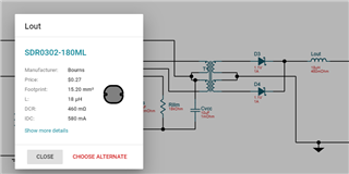

  • Hello Andrew,
    Turn ratio is ok, how about the calculated inductance value?
    Brian
  • Hello Brian,
    The Lout inductor can be calculated according to equation 2
    Assuming an I_load.min = 0.2A, WEBENCH calculates 18uH.
    Andrew
