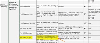

My customer would like to use the ISO1211 for an STO circuit. They have reviewed the documents “Overview STO Concept TIDA-01599” and the associated FMEA “FMEA_STO_Concept_TIDA-01599.xlsx”. And have a question regarding a fault that is also addressed in the FMEA. What happens in the event of an interruption of the FGND, for example, due to a break in the wire at the terminal?
The FMEA simultaneously assumes that INx and SENSEx are open.
However, this does not necessarily have to be the case. There could still be a voltage present at INx and SENSEx. This scenario is not covered in the FMEA, hence my question. Is it also guaranteed in this case that the output will go to logical low?
Additionally, I am interested in what happens in the case of an unstable connection to FGND. For example, if the connection is frequently disconnected and reconnected due to an improper connection at the terminal during vibrations. Is it ensured that the output remains at logical low in this case?
