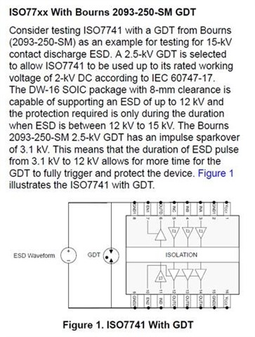

Now I used ISOW7741 & ISO7740 for isolated RS232 design.
According to the "IEC60601-1-2 Compliant Digital Isolation Design with 16-kV Contact Discharge ESD Protection".
The recommended GDT is the 2093-250-SM. However, the moat can only be 2.5mm.
But The DW-16 SOIC package with 8-mm clearance is capable of supporting an ESD.As far as I know, at least 4mm of clearance is required.
Should I use this GDT or would you recommend another part or a DIP type instead?

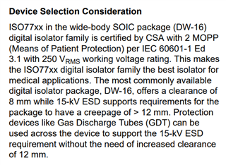

    Clearance really depends on the ESD Level Protection that you're targeting. If the the target is 15kV and above then >12mm Clearance is required without any GDT across isolation
    If your requirement is 16kV, you can go ahead with with recommended GDT in the Appnote, 2093-250-SM.

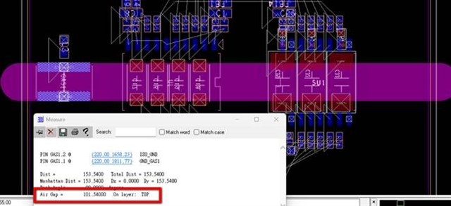

    Thank you for your response. Please allow me to clarify my question.
    This case is applied in medical instruments, and IEC 60601-1 mentions that Hi-Pot 1.5kV electrical isolation must be met.
    As far as I know, under these conditions—Pollution Degree 2, FR4 material, and a working voltage of 1.5kV—the clearance distance should be at least 4mm.
    As I mentioned earlier, the clearance distance of the 2093-250-SM is only 2.5mm.
    Using this GDT will not maintain the required 4mm clearance.
    Should I continue using this GDT and maintain the 2.5mm clearance, or do you have any other suggestions?

  • Hi Jim,
    Thanks for the details.
    I'm not fully aware of the 4mm clearance requirement as per IEC 60601-1 standard and how does it really affect the Isolation performance.
    If the 4mm clearance is a must then a higher clearance GDT might be unavoidable but I don't have a part number to suggest right now for this as we have tested only for 2093-250-SM with 2.5mm of clearance
    Varun
