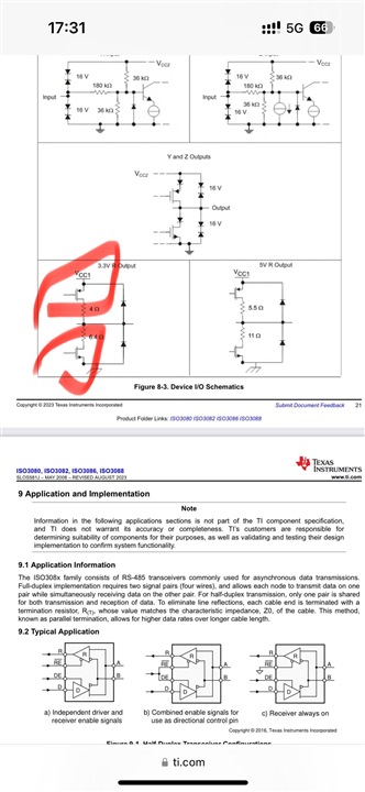

Hi team,
My customer is using ISO3082, need the internal MOSFET RDS-on spec, could you pls share the spec? Thank you!
Yunjing
  • You can compute is as VOL / IOL or (VCC − VOH) / IOH.
  • Hi Yunjing,
    Thank you for reaching out.
    As Clemens stated, the value calculated using the equation that he provided. This is going to give you a typical value for that unit. If customer wanted to know the range of this resistance, then I would like to confirm that the value is expected to be between 50Ω and 150Ω for R output. Thanks.
