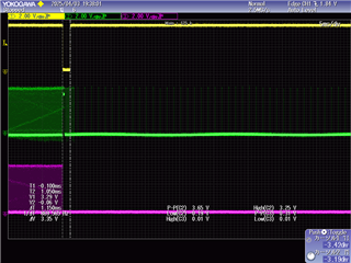

  • Hello, Rao-san
    Thank you for your reply.
    I was able to capture the waveform when the problem occurred.
    Does this tell you anything?
    I'm currently checking with the company about the circuit.
    The configuration is as follows:
    PC (USB micro B) → ISOUSB111 (SSOP) → AT91SAM (USB Port)
    Yellow: Trigger (CPU RESET), Green: UD+, Purple: DD+
    Yellow: Trigger (CPU RESET), Green: UD-, Purple: DD-
    Yusuke Oodaira
  • Hi Yusuke-san,
    Sorry, I couldn't make out anything from the waveform shared.
    May I know what is Trigger waveform? I would like to see UD± and DD± all in the same capture so that I can compare if the device is causing any data mismatch.
    I will also wait for the schematic for review, thanks.
    Koteshwar Rao
  • Hello, Rao-san
    Thank you for confirming.
    I am unable to obtain UD± and DD± waveforms simultaneously.
    I will give up using this device.
    Thank you for your assistance.
    Yusuke Oodaira
