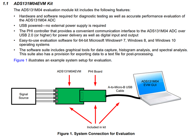

  • Hi Varun-san,
    Thank you for your advise.
    Let me explain my situation again.
    The interface between ADS131M04EVM and PC is USB, not SPI.
    About ADS131M04EVM kit, it has a USB interface with PC.
    ADS131M04EVM Evaluation board | TI.com
    The ADS131M04EVM kit includes the ADS131M04EVM board and a precision host interface (PHI) controller board that enables the accompanying computer software.
    As the EVM kit consists of EVM board + PHI board, we can connect the EVM with PC via USB.
    So I thought I could use ISOUSB211DPEVM to isolate ADS131M04EVM and PC.
    Is my understanding not correct ??
    Takumi
  • Hi Takumi-San,
    Thanks for the further details. I misunderstood the ADS131M04EVM kit.
    As long as the EVM kit gives a USB Protocol Output, ISOUSB211 can be used. Answering your first question:
    should we prepare external power supply for ISOUSB211
     The Supply used for ADS131M04EVM can be used for the Side interfacing with it. We have on board LDO on ISOUSB211EVM  or if you want you can use direct 5V or 3.3V supply based on what is available for the ADC EVM.
