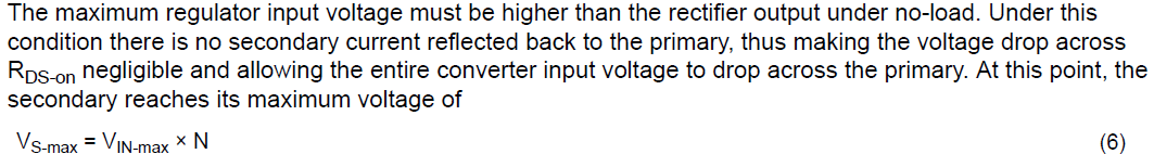

Is it possible to use the voltage double configuration (Vout=2*Vin*D*2*Ns/Np) for wide range input (with duty cycle control)?
Thank you,
Thank you,
Hi Vishwas,
Theoretically it is possible.
Thanks.
Hello Mathew,
For the diode reverse voltage maximum rating should we need to consider same formula?
Thank you,
Hi Vishwas, Shinu is out of office until next week.
The same Vr formula should apply as you'll still have double Vin across each pair of diodes in the bridge.
Ray
Hello team,
If we consider voltage doubler concept, next circuit absolute maximum rating is same formula or should be multiplied with 2?
Thank you,
Hi Vishwas,
All device needs to rated for expected max output voltage.
Thanks.
