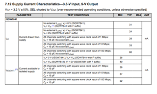

1. What is the current requirement at input side for INx and Vcc (Supply) at my requirement.
2. Max 40mA load current at Viso?
Hi Yamuna,
Please find my inputs below:
Refer Section 7.12 in Datasheet for Supply Current Values ICC(Current at VCC) and IISO(out)(Current at VISO).
Yes, the 40mA is the additional Load current supported by the device from VISO Pin.
Current through INx is +/-10uA. Refer IIH and IIL specs in Section 7.11.
