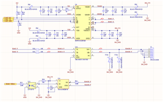

Dear All
Can you review the attached schematic for the ISOW1432DFMR that I use on the RS485 interface of my sensor board?
Should the references of TBU-RS055-300-WH and TISP4350H3BJR-S that I use here for protection after isolation be ISO_GND or GISOIN?
The same question applies to LTV-817S and TS5A3166DBVR.
So should I use ISO_GND on GND2, the reference of VISOOUT, or GISOIN, the reference of VISOIN, as reference after the isolator?
Also, is there anything missing, wrong or needs to be improved in the design?
  • Hi Bekir,
    Thanks for reaching out. Please find my inputs below:
    1. The reference for secondary side components should be GISOIN and not ISO_GND.
    2. Connect GNDIO to GND and not GND1.
    I don't se any other shortcomings here.
    Varun

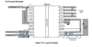

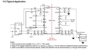

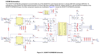

  • Hi Varun,
    Thanks for your quick response.
    I have quoted connecting GNDIO to GND1 from ISOW7741DFMEVM user manual and ISOW1432DFMR datasheet, images are below.
    Can you explain why I should connect it to GND?
  • Hi Bekir,
    Apologies for the confusion here. I did not mean my second comment in a negative way.
    The schematic will work absolutely fine, it's just that connecting the GNDIO after ferrite bead can give you marginal improvement in emissions that's it.
    Varun
