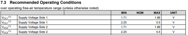

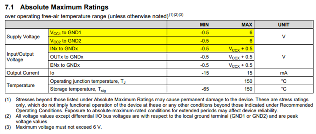

We want to reduce the power consumption of our application and plan to switch from ISO7742 to ISO7401 for uart isolation (3.3V)
ISO7041DBQEVM was purchased and connected to 2 uart ports and worked properly. However, when I disconnected the power supplies to the ISO7401, the communication btw 2 uart kept going through the ISO7041DBQEVM as if the power supplies were still on.
Checked with the scope and the waveforms are clear and sharp on both ends for both RX and TX.
I am assuming the ISO7041 is somehow powered up through the pullups on RX and TX of both ends but don't know if it's true. Please share some insight with me on this phenomenon because it's so attractive to me to use ISO7401 without power supplies under specific scenarios (such as: pull up resistors exist and connect to a power supply on both ends for UART communications only to reduce more power consumption.
A second question is: if that works, does it work with a 5V uart on one side and 3.3V on the other?
