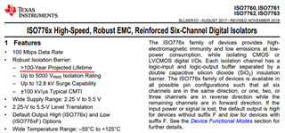

We found that the lifetime year is changed from 100y to 30y. Could you help to explain why?

    The old standard IEC 60884-11 lifetime margin was 87.5% which resulted in >100yrs lifetime measurement.
    The new standard  IEC 60747-17 redefined the lifetime margin to 50%. This is why we have updated our lifetime and plots to match the new standard.

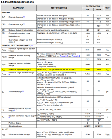

    One more question about the max. impulse voltage. Is there VIMP > 9.6KV isolator available?
    Application: 3ph Solar Inverter
    Brian
  • Hi Brian,
    TI does not currently offer 6 channel digital isolators with VIMP>9.6kV.
    However, TI does offer the ISO78xx family of isolators which supports a VIMP of 9.8kV. Please see the insulation specifications below for the ISO7841:
