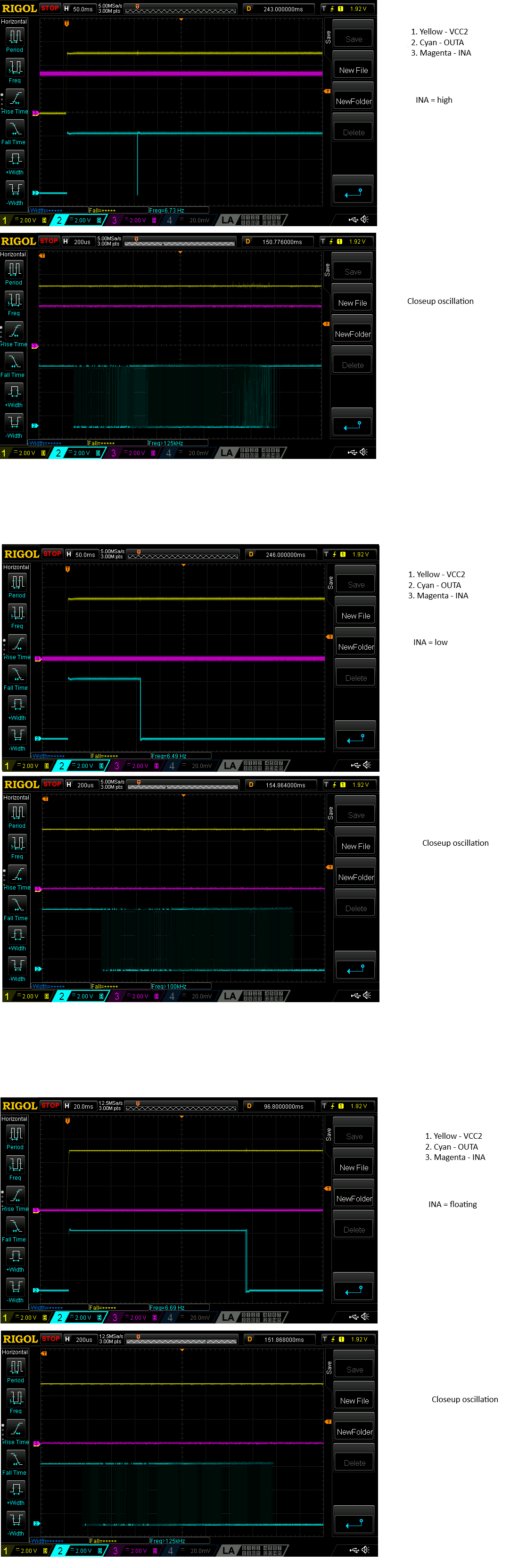

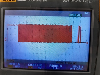

I have used 6 ISO7742F on a PCB of which the first 20 are produced. On one PCB, one channel of a particular ISO7742F goes high as soon the secondary voltage is applied. Is stays high for approximately 300ms (first picture). It does not matter if the power supply of the input of that channel is powered on or off or if the input of that channel is low or floating. After the 300ms the output is oscillating and goes low (second picture). The channel then functions as specified. If the input is set high when the secondary voltage of the ISO7742F is applied, you can see the oscillation after 300ms while the output remains high.

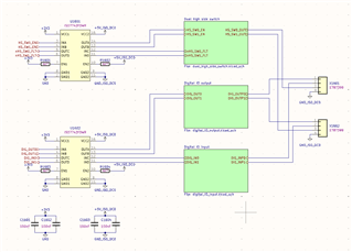

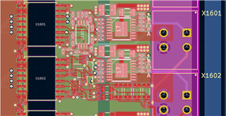

    2. Can you please attach the schematic of the board and also the PCB layout of the board as well?

    2. See attachements below, i made a screenshot of the schematic part and the pcb layout. The isolators are used for some simple digital IO, where the same circuits are repeated six times.

    4. Input conditions of the isolator - primary supply 3.3V, secondary supply 5V, input frequency 0Hz. The input conditions were low, high and floating. Ofcource when the input is high the output remains high, you can only see the osciilation part after around 300ms. It does not matter if the input section of the device is powered on or off, the output signal remains the same.

    1. The output signal always goed high at startup, regardless of input. After 300ms it oscillates then goes to correct state depending on input signal.

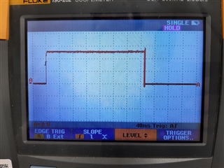

    I noticed that on the measurements done with the Rigol scope the 300ms has halved to around 150ms - it seems that when GND1 and GND2 of the ISO7742 are connected (which was done by means of the oscilloscope) the time is halved to around 150ms. Same result was seen by the Fluke scope.
