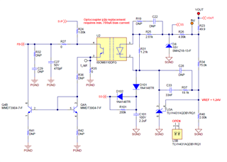

I am considering opto emulators for my designs but i have a large problem: minimal current.
I few time already i considered them and asked here ( or my collogues) IF  SMPS ICx/y/z is compatible with
Opto emulators and it was a no all the time. This time i did a reference design search and there seems to be only
https://www.ti.com/tool/PMP23470#description as a reference design that uses optoemulators.
Is there a list of SMPS ICs that are opt emulator compatible?
There is so FEATURE tag that filters them and there is no column with FB current so i cant filter based on that too.
So am i stuck checking each IC by hand ?
Also are there any SMPS ICs what work with digital FB? something hysteretical probably?

  • ISOM811x devices have analog inputs and outputs.
    Why should minimal current be a problem? The SMPS IC is not directly connected to the input of the isolator.
    I'd guess that nobody wants to make a positive statement because it has not been tested.
  • Hi Clemens,
    The IC i did check was using a complex FB that involved a internal current source and some Pmos and current mirror .
    So yea in retrospective it was something very special that didnt meet the optoemulator min current.
    It is one of the LLC controllers, the one that ends in UCC256xxx  60 or 61.
    I was checking the flyback/forward portfolio and yea never saw something like current sources and all were FB directly in some comparator/opamp.
    Yeeeea probably most will be fine but there is that one IC in 100 that cant and according to Murphy's Law that IC will be my IC so i need to be carefull.

    You mean instead of an Analog Modulated Loopback control using SOM8110 (Ic=If*CTR) you're looking for an ON/OFF modulation - Under Isolation Portfolio the Answer would be NO here. But if you're looking for a SMPS IC - then I need to to push this request to the Power Switches Team who can guide you the best here. You can also ask it in a separate e2e thread parallelly while I respond on other aspects of your query.
    Varun
  • Hi Kumar,
    Yes i was wandering if there were ICs that have ON/OFF FB and 2-3 pins but if there are none there is no problem.
    As for something that i can control with ISOM8110 i am still looking UCC2897A LM5026 / 25 are strong candidates that I am considering as of now.
    the LM50xx have FB that goes through a current mirror , there may be problems with IOSM minimal current but theoretically i think it could work ,not sure .
    Barely work and work well are VERY different. and yea i am not rushing the IC choice.
    Robert

    Thanks for your patience. Based on the feedback received from SMPS Team  UCC256612, UCC2897A LM5026 / 25 should be compatible with the ISOM8110.
    Team is working on releasing a reference design with UCC256612 and should be applicable to other mentioned controllers as well since they have an inbuilt REF Supply to bias the ISOM8110 properly. I will update on this as soon as I have a sharable information.
    May I know what is your thought/criteria (maybe a possible biasing circuit that you might've though of) when you're proposing these ICs for compatibility check with ISOM8110?
    Varun

    Fortunately, all of the controllers you looked into can be compatible with ISOM8110 but we currently don't have a reference design to share with you.
    A reference design is expected to release in coming weeks using UCC256612 on ti.com. Please have a lookout for that. Below is an example bias circuit for ISOM8110 with FB pin and REF 5V output of the controller:
    We've taken your valuable inputs for making a list of SMPS ICs and add opto-emulator compatibility as a feature column on ti.con and will progress on it.
    I don't have any other inputs from my side to share with you right now, hence I'm closing this thread. Please feel free to reach out to us for any further question on ISOM8110
    Varun
  • Hi Varun,
    That sort of clears it for me. I picked IC that i sort of expected to be of so i decided well nice to know. Regarding the UCC256612 i suppose the NPN pair Q4 in a current mirror configuration is there to help with the current draw by mirroring the opto current.
    On a side note if i remember well for LM5046/5 there was a nice current to duty cycle relation: 1mA was 100% 0ma was 0 duty .
    So in that case ill have on the secondary the *normal* FB circuit and on the primary ill have that current mirror and then ill have to play with R24 and R35 / R36 in order to make sure i have that required 0.7mA through the device and then over that the 1mA i need for the FB ( if i understand well) .
    I cant thing well of how the current will work but i will use some SPICE and play with resistor values and see what i get.
