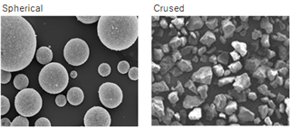

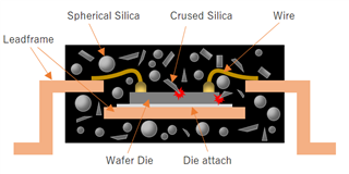

  • Dear Varun-san,
    Mold compound contains fused silica as one of its ingredients.
    Fused silica comes in two main shapes: spherical and fractured (irregular shape).
    Because fractured fused silica has a sharp shape, it poses the risk of damaging the wafer die during molding.
    This defect is called a "filler attack (caused by fractured fused silica)".
    Question: What is your opinion on the concern of "Filler Attack" when using mold compounds containing Crushed Silica?
  • Hi Junji-san,
    Thank you so much for clarifying your concern.
    The Packaging team has confirmed that we only use spherical fillers in our mold compounds, hence there should be no concern of damage to the wafer die.
