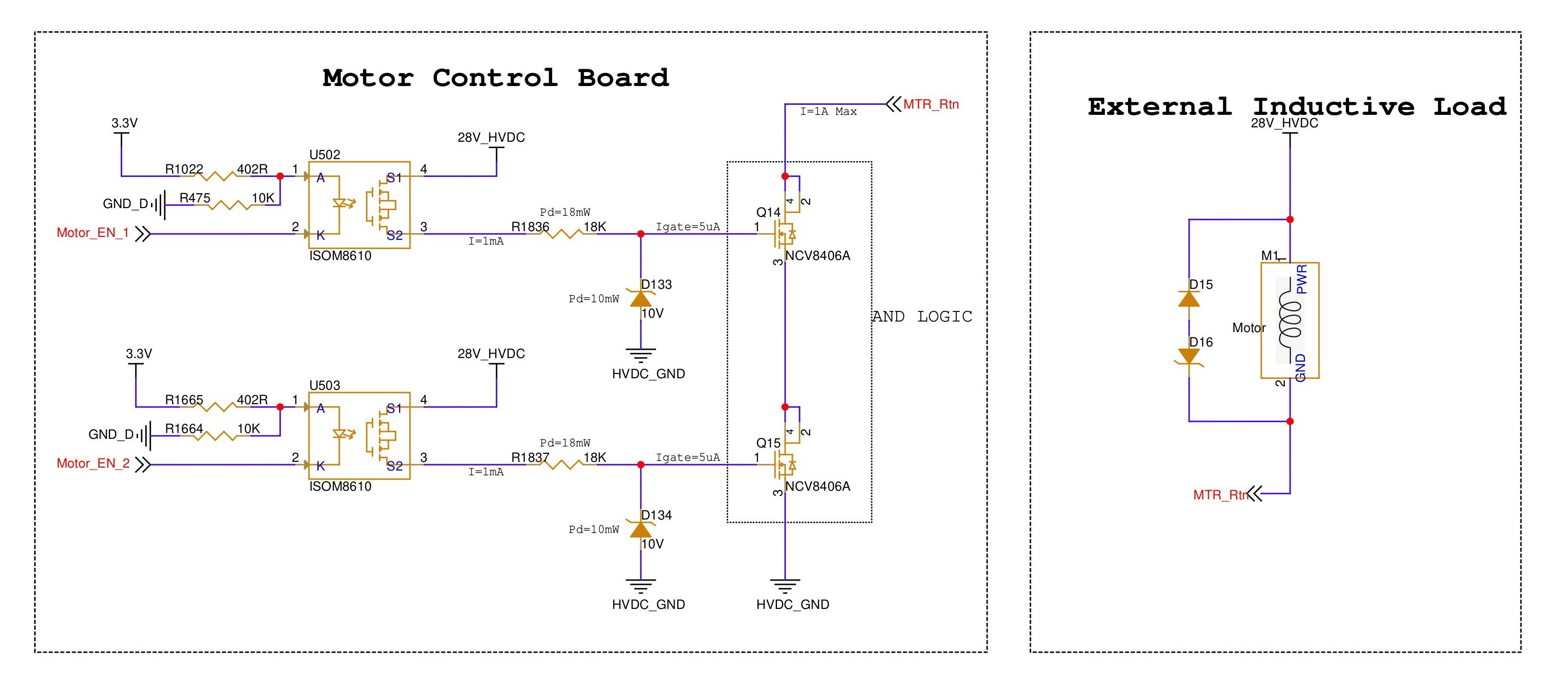

We are planning to use the ISOM8610 solid-state relay (SSR) to isolate the microcontroller outputs from the high-voltage DC (HVDC) side in our custom motor control board. The target load is an inductive fan motor with a maximum current rating of 1A.
Since the ISOM8610 cannot handle 1A through its output pins (S1/S2), we are using it only to drive the gate of an external MOSFET. This MOSFET will provide the return path for the motor current.
We are receiving two independent logic signals: Motor_EN_1 and Motor_EN_2. To ensure the motor turns on only when both enables are active, we have configured the external MOSFETs in a series (ANDed) configuration. The schematic snippet is attached for your reference.
One point of concern is that we have placed a resistor and Zener diode at the S2 pin of the SSR to clamp it to 10V, rather than grounding the source pin it directly. We would like to confirm:
  • Will this configuration provide sufficient VGS ( i,e is VGS > VGSTHto turn on the internal MOSFET of the SSR?
  • Will the SSR operate correctly in this configuration?
Your feedback on whether this design approach is valid and safe for switching the inductive load is greatly appreciated.

  • Hi Sameep,
    Thank you for reaching out. Please find my inputs below:
    Yes, the ISOM8610 is a bidirectional switch and will pass 28V_HVDC Signal once turned on through input forward current.
    The SSR ISOM8610 will work absolutely fine in this configuration
    Just One comment : Please check how you intend to bias Q14 gate. It is a NMOS with Source floating on High Side. Enable Q15 first and then Q14 for it to switch ON.
