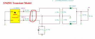

I did search around these forums for an answer to my question but I did not see a thread with a direct answer to my question.
I do have a tina file for the SN6501 but it does not include the transformer to create wanted output voltages.
I have added a tina file that has a modeled transformer but it may not be 100% correct. This is where I need a little help.
I was trying to duplicate the circuit shown on page one of the most recent datasheet.
The simulation does not result in seeing a DC output voltage, mainly garbage at this time.
Just looking to see if someone can provide a little guidance in correcting my tina file?
dennisSN6501 basic simulation.TSC

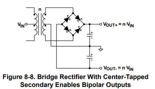

    Maybe I should just ask you my end goal here.  For the SN6501, do you have any suggestions for a transformer to use to get a 2.5V output using a 3.3V input? Seems to me I need a step down transformer now to go to a lower voltage.
    I know this is a different topic than what I initially asked about but this is what I was trying to determine via simulation.  The datasheet for the SN6501, while it does provide formulas for calculating a required transformer value (or turns ratio) it does so using mainly 5V and 3.3V scenarios.  There is also an assumption that one has a LDO regulator following, which we do not.
  • Hi Dennis,
    Thanks for clarifying the query.
    In most of the use cases, common rails are 3.3V/5V that is the reason the recommended transformers and reference designs are mostly for 3.3V and 5V.  One possible option to generate 2.5V is to use a recommended 3.3V to 5V transformer and configure the output in center tapped full bridge configuration.
    Thanks.

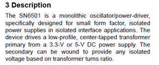

  • Hi Shinu,
    The datasheet of this part does state that it can be used for any output voltage, provided you have a transformer for it:
    We do have Vcc at 3.3V so we are following the datasheet recommendations.

    I was able to contact some others inside of TI that saw a problem with my original simulation above.  I just had two extra connections that I forgot to delete that was causing problems.
    The simulation works ok now.  I have also attached the tina file that shows this.
    SN6501 basic simulation fixed.TSC
    This ends this thread.
