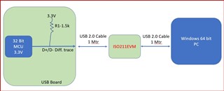

Our industrial control board has USB 2.0 Interface , FULL speed ( 12 Mbps ) HID Device.
Currently , Between MCU and USB Connector , EMI filter and TVS Diode is Used. 90 Ohm Differential Impedance  achieved using 4 layer PCB Layout.
During Normal scenario , communication works fine between PC and Board.
Issue is : when we have Industrial premises , due to noise we are facing communication Failure and Data Corrupt issue.
Can ISOUSB111 is best suits to resolve this ? or you can suggest any other part as well.
